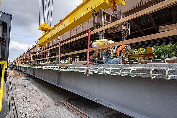

Small MTA VIA DUCT South Phase 1

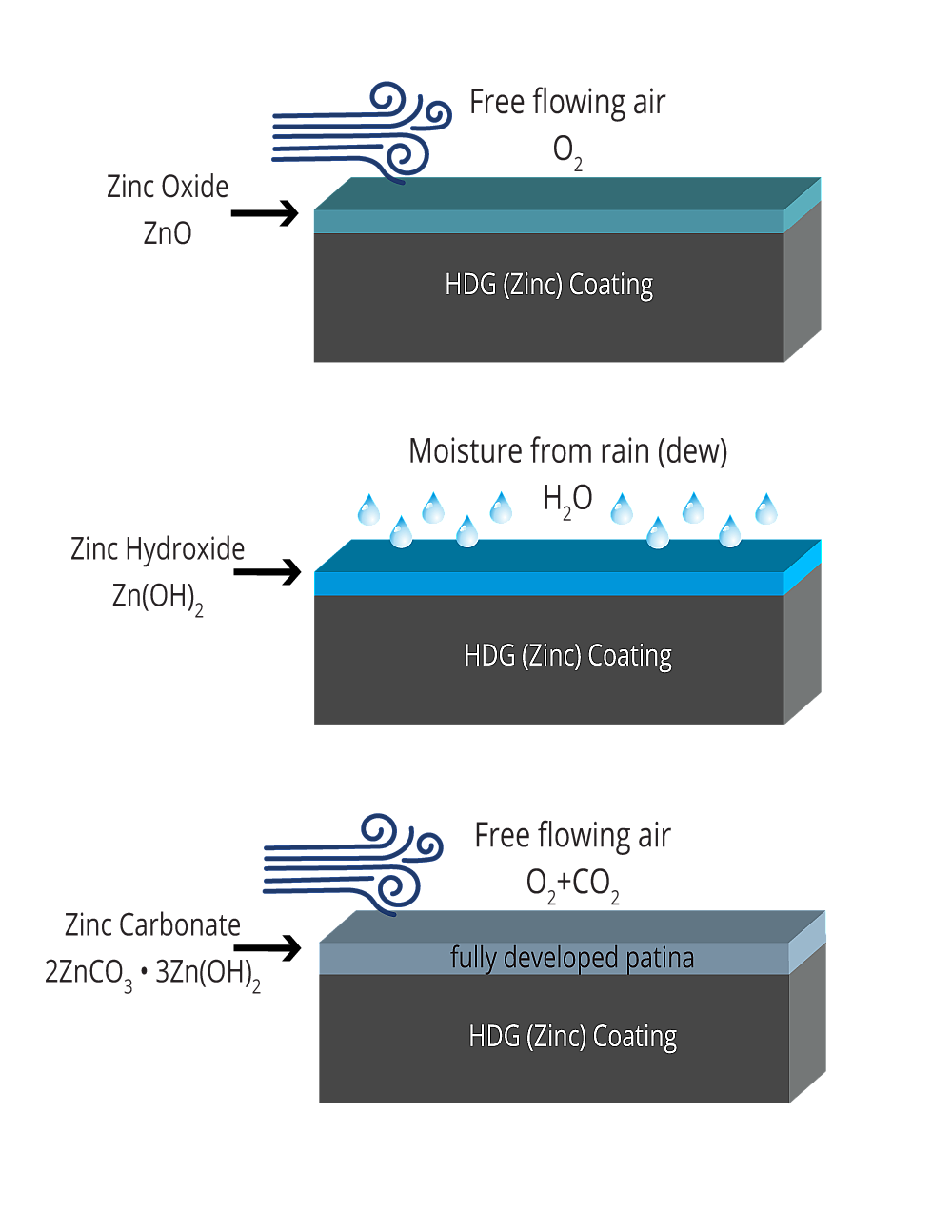

Zinc Patina Development
Finally, as zinc weathers, it reacts with oxygen, moisture, and carbon dioxide to form corrosion products—primarily zinc oxide, zinc hydroxide, and eventually zinc carbonate. These compounds develop into a dense, adherent patina that acts as an additional barrier called the patina and significantly reduces the corrosion rate.
This patina does not “seal” the surface like a paint film, but it slows the transport of moisture and contaminants, allowing the coating to corrode at a lower and more predictable rate over time.
The practical takeaway is simple: galvanized steel is self-protecting at both intact and damaged locations.
Med zinc patina dev
Formation of the Zinc Patina
