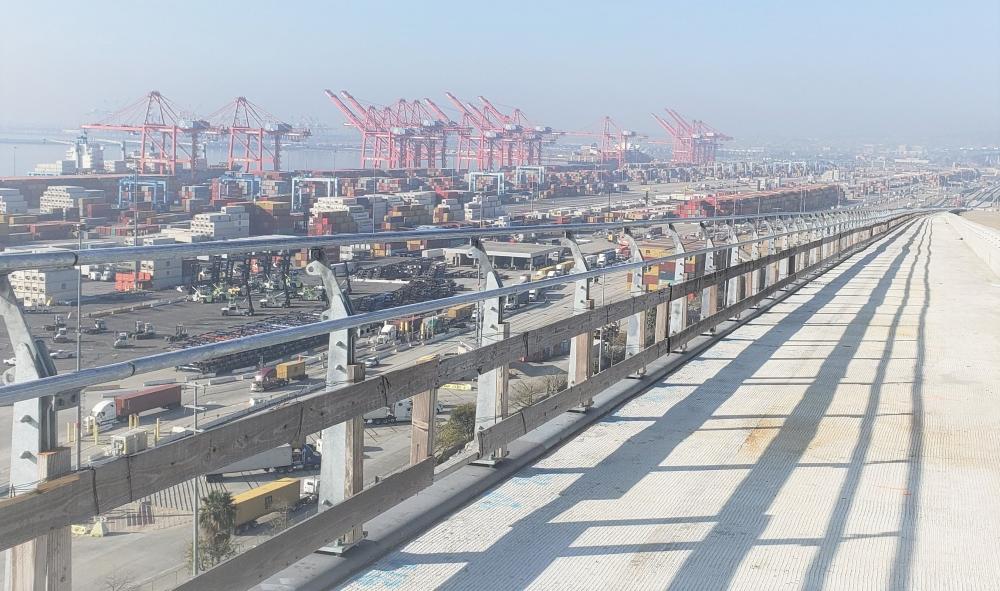

Gerald Desmond19 01
In coastal regions where increased or aggressive corrosion is probable, you can consider utilizing a duplex system (paint or powder coating over galvanizing) to extend the service life. A duplex system can provide maintenance-free corrosion protection for 1.5> times the sum of the paint life and galvanizing life. In these environments, some owners benefit from rinsing their HDG steel with potable water. This can be important for sheltered structures that do not benefit from rain rinsing.

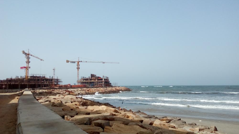

Coast of Karachi construction
While coastal areas are generally corrosive to most construction materials, HDG still provides effective and long-term corrosion protection for many projects. If a structure is designed to assist drainage, is well ventilated, and sheltered from marine splash, spray, or salty prevailing winds, HDG has been known to perform suitably. As HDG is a metallic coating, efforts to prevent bimetallic corrosion in coastal environments are also important for maximum longevity.
