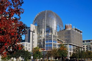

San Diego Central Library
The San Diego Library is another example of a successful galvanized AESS project.
The key takeaway from this categorical approach is AESS categories do not need to be equally applied across a project: AESS 1 or 2 are more suitable for visible framings high up that will not be closely seen by the public/intended user (or will be covered in heavy coatings or fireproofing), while artwork, columns, or showcase elements to be touched and viewed up close may require AESS 3 or 4. This categorical approach allows you to optimize the quality and inspection requirements for various galvanized members of the project, so you can avoid unnecessary and expensive detailing/smoothing where it is not needed. Additionally, this approach can prevent the project from becoming cost prohibitive if the same highest standard was applied in all areas of the project.

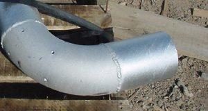

Increased Thickness In Weld Area
Figure 1: Increased Thickness in Weld Area
For example, if welds are required to be contoured and blended the fabricator can perform this before HDG, but depending on the chemistry of the weld material a thicker and/or darker HDG coating may be present over weld area after galvanizing. Therefore, additional smoothing after hot-dip galvanizing is often needed to ensure weld contouring and blending in addition to optional use of recommended welding materials or weld material with a chemical composition closer to the base steel.

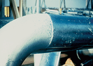

For example, working in direct communication with the galvanizer to optimize placement, quantity, and size of venting/drainage holes in relation to the handling orientation will go a long way to improving the aesthetic appearance. To take it a step further, you may also want to discuss temporary/designated lift points to minimize the appearance of chain and wire marks. Material selection also has a major influence on the HDG coating appearance. Combining steels of different material thickness, steel chemistries or initial surface conditions will result in a mixed appearance after hot-dip galvanizing.
Different Steel Chemistries
Figure 3: Combining steel of different chemistries may result in mixed shiny/matte appearance.
Where unavoidable, materials can be sent to the galvanizer separately in an attempt to match appearance before bolting/welding after galvanizing or abrasive blasting before HDG can be specified to maximize the potential for a uniform appearance.

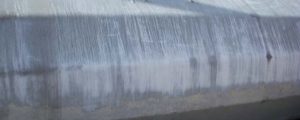

Preventing Wet Storage Stain
After acceptance of the material, hot-dip galvanized articles should be stored in a way to minimize the occurrence of wet storage stain.
Wet Storage Stain Example
Figure 4: Wet storage stain

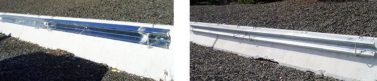

The presence of light or medium wet storage stain does not negatively affect the level of corrosion protection and does not require remediation, but for aesthetic purposes it can be removed using commercially available chemicals and a stiff nylon bristle brush. Despite the presence of light or medium wet storage stain, the parts will weather to a uniform appearance over time typically six months to two years depending on the environment.
Wss Appearance Before After
Figure 5: The photo on the left was taken 12/8/02. The photo on the right way taken 03/28/03. Over time, all initial HDG steel appearances will become uniform.
Refer to the AGA publication Wet Storage Stain (also available in Spanish and Canadian French) for preventive measures and cleaning instructions.
