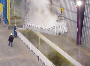

Quench
A passivation coating applied at the end of a hot-dip galvanizing line can be specified or not depending on project requirements.
Immediately after batch hot-dip galvanizing, a passivation of the galvanized surface may be performed to maintain certain aesthetics or provide protection against wet storage stain. These post treatments (hexavalent chromium passivation, trivalent chromium passivation, or chromium-free passivation) are often applied at the discretion of the galvanizer, otherwise their use can be required or prohibited upon request.
