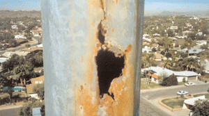

Concerns have risen in the past regarding corrosion at overlap lines which were not sufficiently cleaned when the second end is processed through the galvanizing line.  For example, there was an isolated incident of premature HDG failure in Arizona where transmission tower poles (46 to 120+ feet in length) were galvanized for the Arizona Public Service (APS). In 1988, APS discovered a significant number of poles developed severe through-wall corrosion (Figure 1). The poles in question were only in service for 11 years before signs of severe corrosion were noticed in a normally low-corrosivity environment.
Figure 1: Example of Internal Corrosion due to Entrapped Flux
The accelerated corrosion initiating from the interior of the poles was a result of flux entrapment caused by the combination of progressive dipping with:
  • Poor venting/drainage hole design  The structure had only small vent holes and, in many cases, more severe corrosion was found on sections where end plates had been welded to the tubes, further limiting the flow of fluxing solutions and zinc. Additionally, since the vent holes were sealed, moisture resulting from condensation wetted the flux residues, causing corrosive chemical solutions to run the length of the interior.

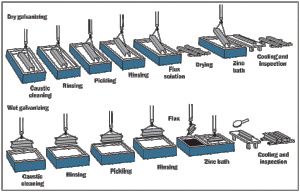

  • Wet galvanizing  In this process, a molten flux blanket floats on the molten zinc in the kettle. A part is passed through the blanket upon submerging into the kettle, and the blanket is then paddled back upon removal from the kettle. Any floating flux that may become attached to the part must be removed.
When a tubular product is progressively dipped using a wet kettle process, the chance for flux entrapment is high. However, over time the galvanizers in North America have moved away from wet kettles and toward the “dry galvanizing” process where fluxing is performed separately before immersion in the kettle (Figure 2).
Figure 2: Dry vs. Wet Galvanizing Process
Currently, very few wet kettles remain in service. When a tubular product with proper venting/drainage holes is progressively dipped using a dry kettle, the progressive dip process does not result in concerns over internal corrosion of tubular products due to flux entrapment. As a result, progressive dipping of tubular products is now commonly and successfully performed in the industry today.
