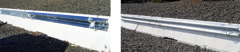

Wss Appearance Before After
The photo on the left was taken 12/8/02. The photo on the right was taken 03/28/03. Over time, all initial HDG steel appearances will become uniform.
