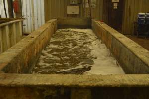

Is SSPC-SP 8 specified for chemical cleaning before galvanizing?
Pickle Bath
SSPC-SP 8 is a surface preparation standard intended for acid cleaning to be performed immediately prior to painting. As such, the standard includes elevated surface requirements that make sense if acidic cleaning is used as the primary method for cleaning and etching the steel surface prior to a coating application. In the batch galvanizing process however, acidic cleaning is only one part of the cleaning process and surface etching is not needed for successful galvanizing. The chemical cleaning stage is followed by an acidic flux treatment, often conducted by immersion into a heated zinc-ammonium chloride solution. This galvanizing flux continues to remove surface oxides on the steel and then prevents further oxidation before galvanizing. Therefore, it is unnecessary for the chemical cleaning process at a galvanizing plant to be held to the requirements of SSPC-SP 8.
