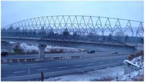

Galvanized Steel Bridge Ontario
Low Temperatures
Studies of hot-dip galvanized steel in low-temperature environments (below -40 F) reveal minimal or no difference in atmospheric corrosion rate. Hot-dip galvanized steel is even utilized in some polar installations for corrosion protection and has been in service for many years. As with any steel at very low temperatures, the material may become brittle with extended use. Regardless, hot-dip galvanizing provides suitable protection against corrosion in low-temperature applications.
