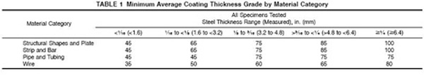

Table 1: Minimum Average Coating Thickness Grade by Material Category | ||||||
All Specimens Tested Steel Thickness Range (Measured) in. [mm] | ||||||
Material Category | <1/16 [<1.6] | >1/16 to <1/8 [>1.6 to <3.2] | >1/8 to 3/16 | >3/16 to <1/4 [>4.8 to <6.4] | >1/4 to <5/8 [>6.4 to <16.0] | >5/8 [>16.0] |
Structural Shapes | 45 | 65 | 75 | 75 | 100 | 100 |
Strip and Bar | 45 | 65 | 75 | 75 | 75 | 100 |
Plate | 45 | 65 | 75 | 75 | 75 | 100 |
Pipe & Tubing | 45 | 45 | 75 | 75 | 75 | 75 |
Wire | 35 | 50 | 60 | 65 | 80 | 80 |
Reinforcing Bar | -- | -- | -- | -- | 100 | 100 |

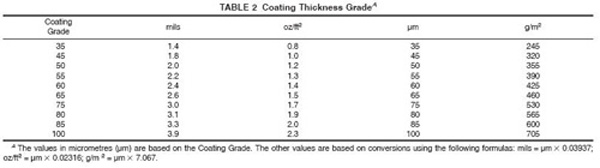

Table 2: Coating Thickness GradeA | ||||
Coating Grade | mils | oz/ft2 | µm | g/m2 |
35 | 1.4 | .8 | 35 | 245 |
45 | 1.8 | 1.0 | 45 | 320 |
50 | 2.0 | 1.2 | 50 | 355 |
55 | 2.2 | 1.3 | 55 | 390 |
60 | 2.4 | 1.4 | 60 | 425 |
65 | 2.6 | 1.5 | 65 | 460 |
75 | 3.0 | 1.7 | 75 | 530 |
80 | 3.1 | 1.9 | 80 | 656 |
85 | 3.3 | 2.0 | 85 | 600 |
100 | 3.9 | 2.3 | 100 | 705 |
A: The values in micrometers µm are based on Coating Grade. The other values are based on conversions using the following formulas: mils=µm x 0.0.937; oz/ft2= µm x 0.02316; g/m2 = µm x 7.067 |
