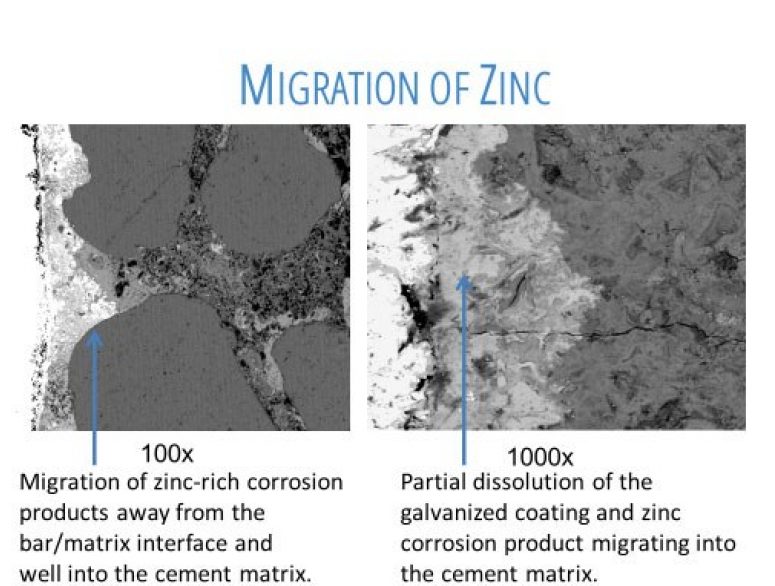

Once the chloride ion threshold is exceeded, the galvanized coating begins to corrode. However, it is important to note the zinc corrosion products migrate into the concrete matrix (Figure 1), meaning cracking and spalling do not occur during this stage.
Migrationof Zinc
Figure 1: Migration of Zinc Corrosion Products into Concrete Matrix

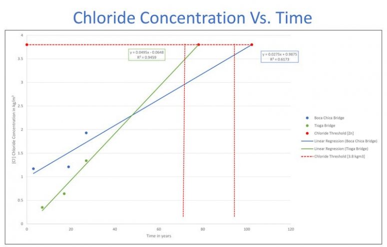

To demonstrate the impact of hot-dip galvanizing for rebar placed in chloride-rich environments, let us review real-world data obtained from two bridge decks. The Tioga bridge (Tioga, PA) is located in a northern climate where road salts are the primary source of chloride ions. Meanwhile, the Boca Chica bridge (Key West, FL) is from a southern coastal climate where the ocean water and salty air result in high chloride ion exposure. These bridge decks were cored over a period of 27 years to determine the chloride concentration and condition of the galvanized rebar.
Chloride
Figure 2: Chloride Concentration vs. Time
At 27 years, both bridge decks experienced chloride thresholds that were above the chloride threshold for black rebar, but well below the chloride threshold to begin corrosion of the galvanized rebar. From the chart in Figure 2, you can see the chloride concentration for both bridges rises over time, but neither the Tioga Bridge and Boca Chica bridges are predicted to experience the chloride threshold for zinc (3.8 kg/m3) until approximately 78 and 102 years, respectively. With this information, we can graph the anticipated performance of the galvanized rebar over the life of a bridge where no maintenance is performed (Figure 3).

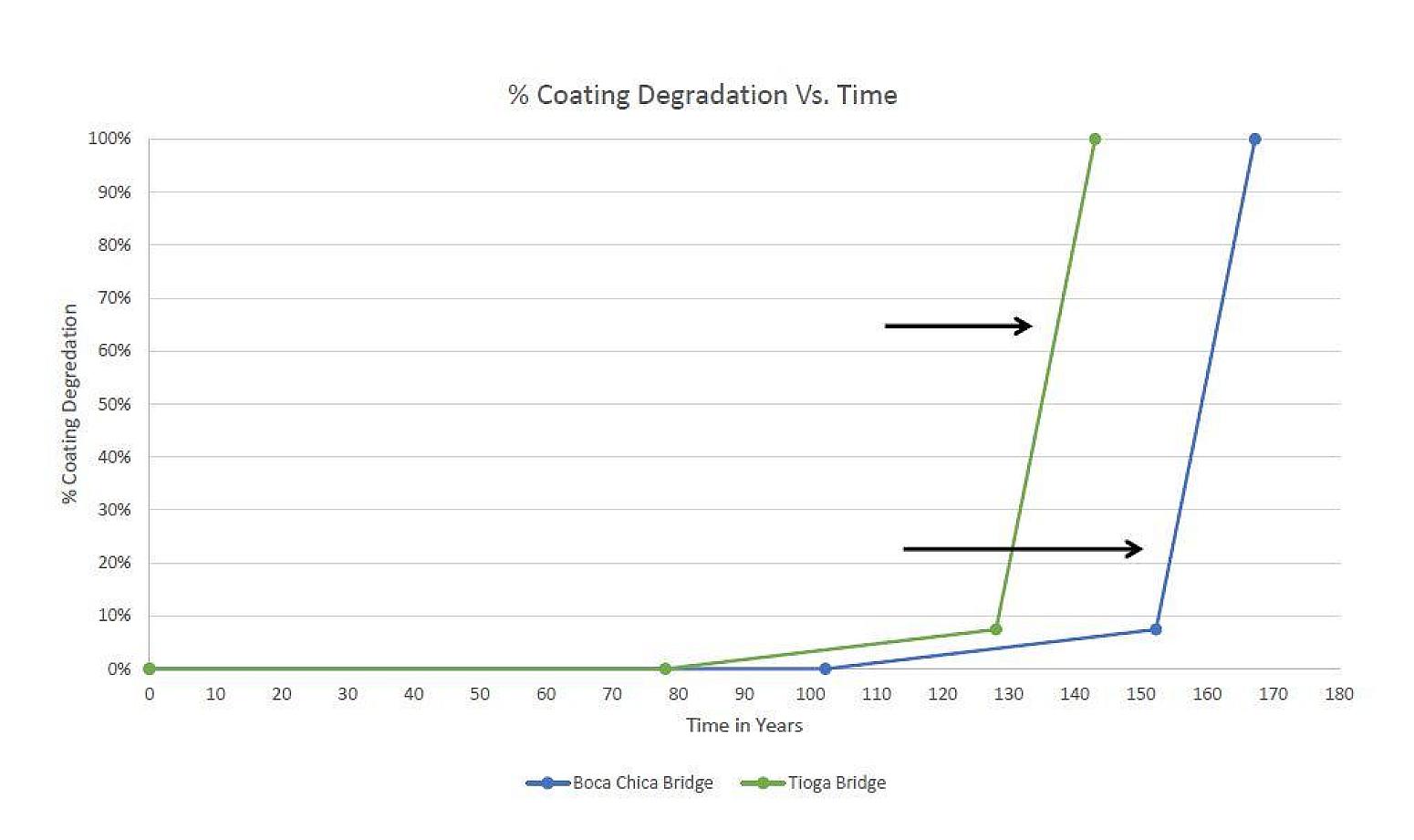

Coating Degradation Vs Time
Figure 3: % Degradation vs. Time in Years
Once corrosion of the galvanized coating begins, a coating weight of 3.5 oz/ft2 provides a galvanizing service life of 50 years. After consumption of the galvanized coating, the bare rebar begins to corrode at a more accelerated rate than the galvanizing until cracking and spalling initiate.
Maintenance-free Service Life = time to chloride threshold + HDG life + black bar life
Tioga Bridge (~143 years) = 78 + 50 + 15 years
Boca Chica Bridge (~167 years) = 102 + 50 + 15 years
