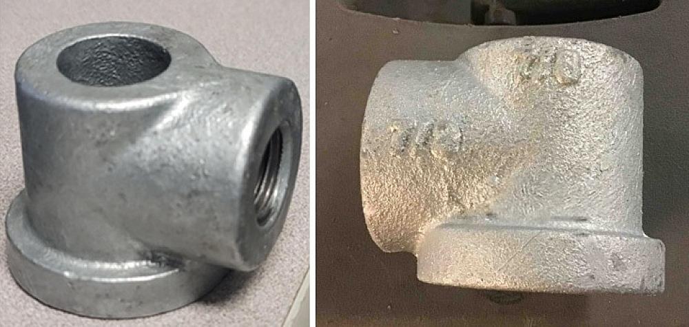

When it comes to initial galvanizing appearance, castings are known for their variability. It’s not unusual to see parts from the same batch range from shiny to dark matte gray (Figure 1). High silicon content accelerates the growth of zinc-iron alloy layers during galvanizing, which can consume the shinier eta layer as the part cools. Process variables like spin time, withdrawal rate, and cooling methods may also influence the final appearance and thickness of the coating, but to a lesser degree. No matter the initial visual appearance of the product, all galvanized castings will take on a uniform matte gray appearance and benefit from the superior corrosion protection provided by hot-dip galvanizing.
Casting image 1
Figure 1: These identical castings were processed the same way, but minor variations in steel chemistry and initial surface smoothness resulted in different initial coating appearances.

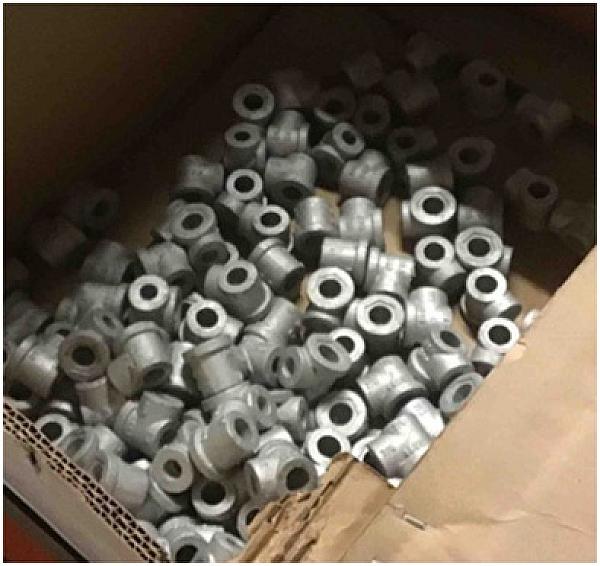

When cast iron is used in assemblies alongside carbon steel, achieving consistent cleanliness and appearance across all components can be challenging due to the different preparation requirements at the galvanizing plant. Occasionally the galvanizer and customer may need to come to an agreement on additional precautions to avoid roughness and pitting.
Castings image 2
Blast cleaning or tumble blasting the castings before hot-dip galvanizing is recommended to improve coating quality and remove embedded sand, graphite, and other residues that can survive the galvanizer’s standard cleaning process. Bare spots on the finished product are usually the result of these contaminants. Using grit or a combination of grit and shot during blasting is the most effective way to clean castings thoroughly and promote a uniform finish. It’s also important to address any surface flaws, such as shrinkage holes or residual graphite, before galvanizing, as these can cause defects in the final coating.
