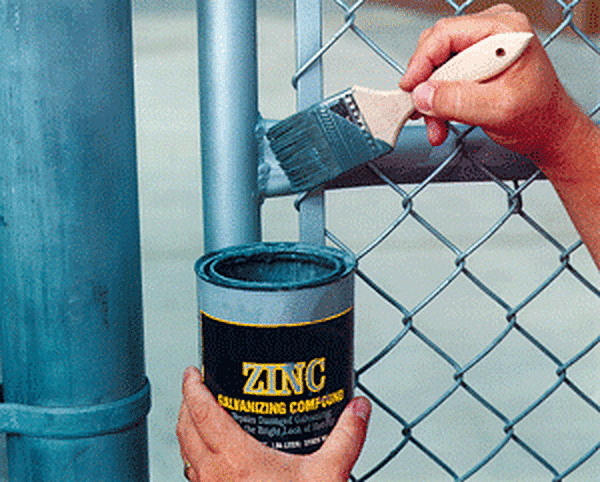

Application of Zinc-Rich Paint
Caption    Zinc  Rich  Paint
Zinc Rich Paint
Zinc-rich paint is applied to a clean, dry steel surface by either a brush or spray. Zinc-rich paints must contain either between 65% to 69% or greater than 92% metallic zinc by weight in the dry film. Paints containing zinc dust are classified as organic or inorganic, depending on the binder they contain. Inorganic binders are particularly suitable for paints applied in touch-up applications of undamaged hot-dip galvanized areas. The coating thickness for the paint must be 50% more than the surrounding coating thickness, but not greater than 4.0 mils (100 ?m).

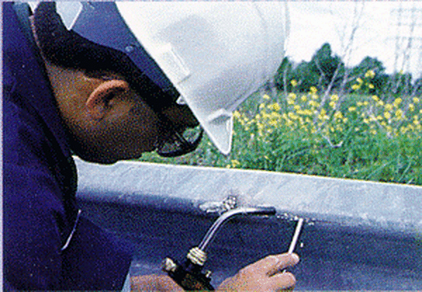

Zinc-Based Solder
Caption    Zinc  Based  Solder
Zinc-Based Solder
Soldering is done with zinc-based alloys in either a stick or powder form. The area being repaired needs to be preheated to approximately 600 F (315 C). The acceptable material compositions of solders used for repair are included in ASTM A780. The repair coating thickness must meet the specification requirement for the material category of the part with a maximum thickness of 4 mils (100 ?m). Zinc-based solder products closely match the surrounding zinc and blend in well with the existing coating appearance.

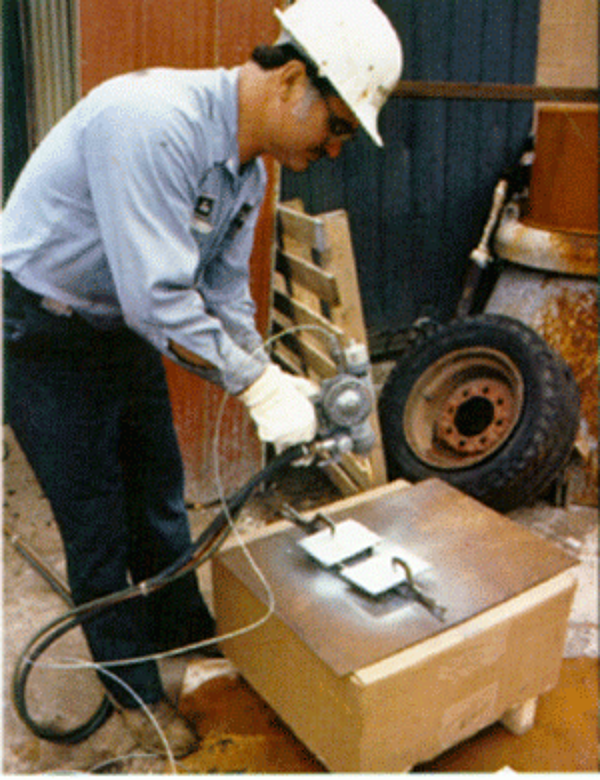

Molten Zinc-Spray/Zinc Metallizing
Zinc Spray Metallizing
Zinc Spray (Metallizing)
Zinc spray, or metallizing, is done by melting zinc powder or zinc wire in a flame or electric arc and projecting the molten zinc droplets by air or gas onto the surface to be coated. The zinc used is nominally 99.5% pure or better. The renovated area shall have a zinc coating thickness at least as thick as that required in ASTM A123/A123M for the material category.
