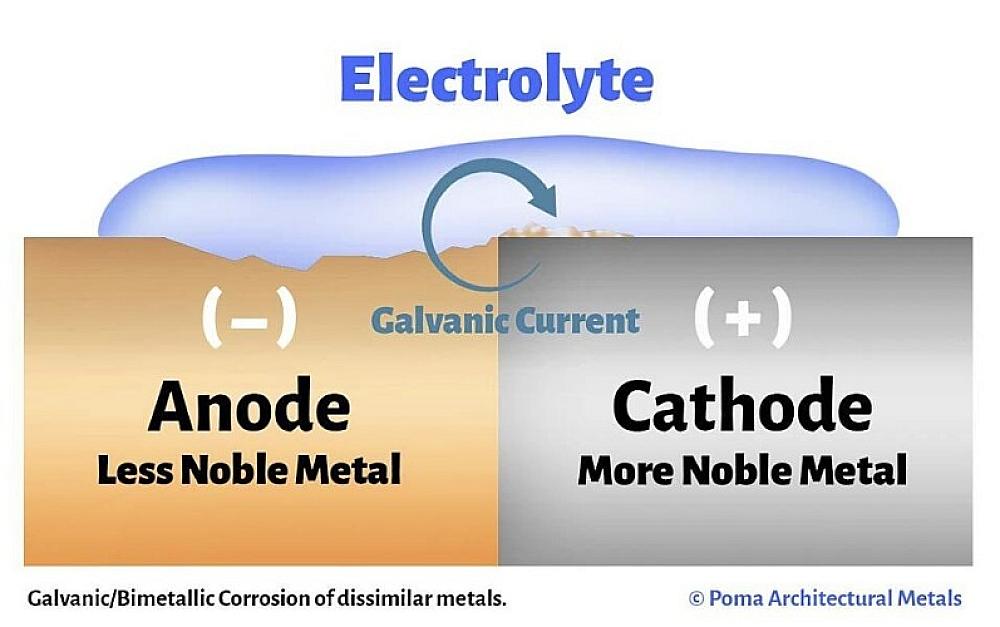

Galvanic corrosion requires four simultaneous conditions: an anode, a cathode, an electrolyte, and an electrical return path. When these conditions exist, a corrosion cell is formed (Figure 1), enabling galvanic corrosion to occur. Although it may take decades for moisture to permeate the concrete and contact the reinforcement embedded within it, if dissimilar metals are contacted a corrosion cell can form.
For more information on hot-dip galvanized steel in contact with dissimilar metals, refer to AGA guide on Dissimilar Metal Corrosion with Zinc.
Figure 1 2026
Figure 1: Components of a Galvanic Corrosion Cell.
