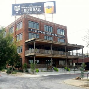

The Boulevard Brewery Co. visitor center in Kansas City, Missouri utilized a proprietary rustic color technology to showcase and preserve the old-school charm of the building.

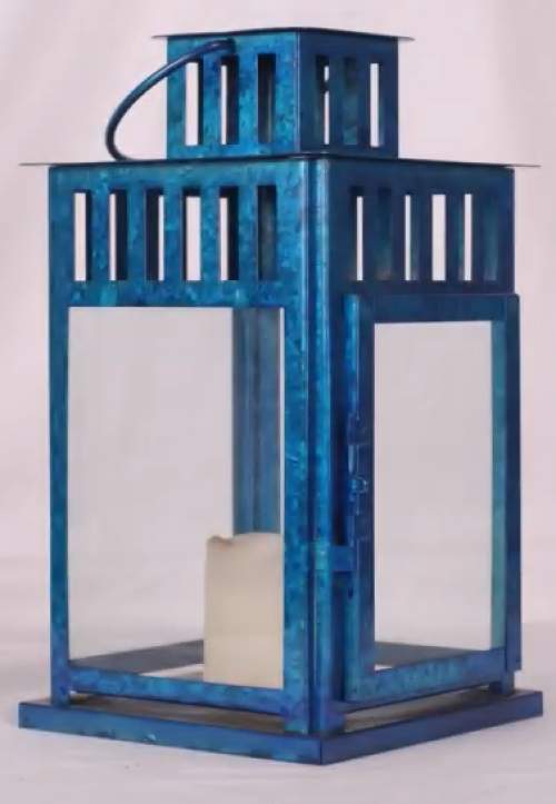

For users of galvanized steel interested in achieving a specific color while preserving the initial appearance of the galvanizing such as spangle, mottling, mixed appearance, or other initial galvanizing appearance – BRUGALCOLOR® is a passivation technology which offers a variety of long-lasting translucent colors.
Brugalcolor

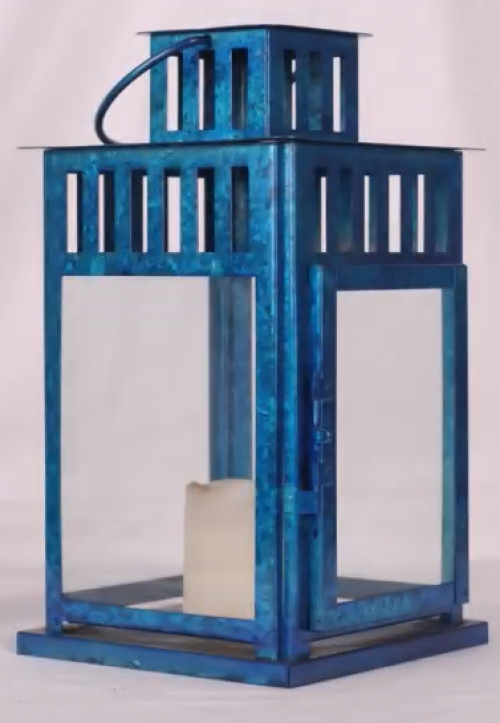

Colored passivations are available in a variety of long-lasting translucent colors.

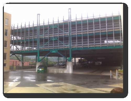

Parking Lot With Brugal Color
City Parking Garage in Fitchburg, MA after 10 years.

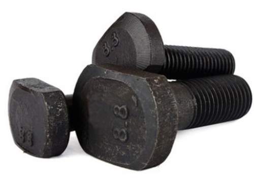

Black Oxide
Black oxide is a conversion coating which produces an oxidation product on the galvanized surface, resulting in a blackened finish that can range from soft black to jet black. Finish may vary, but tends to be relatively smooth and glossy.
Black Oxide
Black oxide provides a industrial appearance which can vary in darkness.
