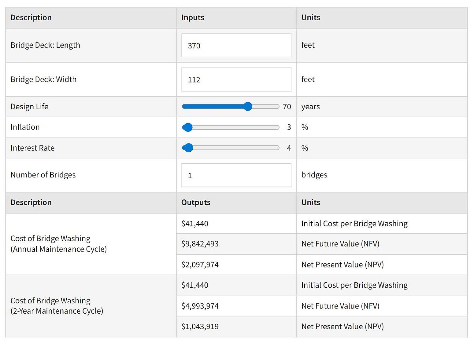

Example Bridge
Lane Ave 3
For projects where bridge maintenance costs are considered, obtain information about the specific bridge deck size and design life for a quick analysis. If analyzing a bridge bundling project (assuming multiple bridges similar in design and size), it is recommended to identify the average bridge deck size and quantity of bridges. Afterwards, results from the bridge washing calculations can be used to demonstrate costs over the life-cycle when accounting for annual or biannual washing.
In this generic example, the cost of each bridge washing maintenance activity is approximately $41,440 (in today’s dollars) assuming the use of third-party contractors. It is assumed many bridge owners outsource this maintenance activity, but not all. Over a design life of 70 years, the cost of annual sweeping and washing increases the life-cycle cost by approximately $2.1 million in today’s dollars.

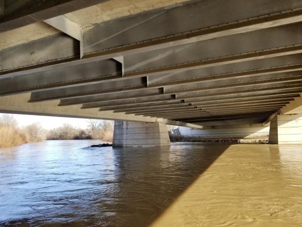

Lane Ave Bridge Case Study
The effect of washing the bridge annually versus every two years on life cycle cost.
