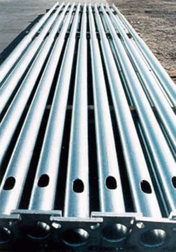

![Galvanized Pipe](/uploads/default/_600xAUTO_crop_center-center_75_none/Galvanized-Pipe.png)
