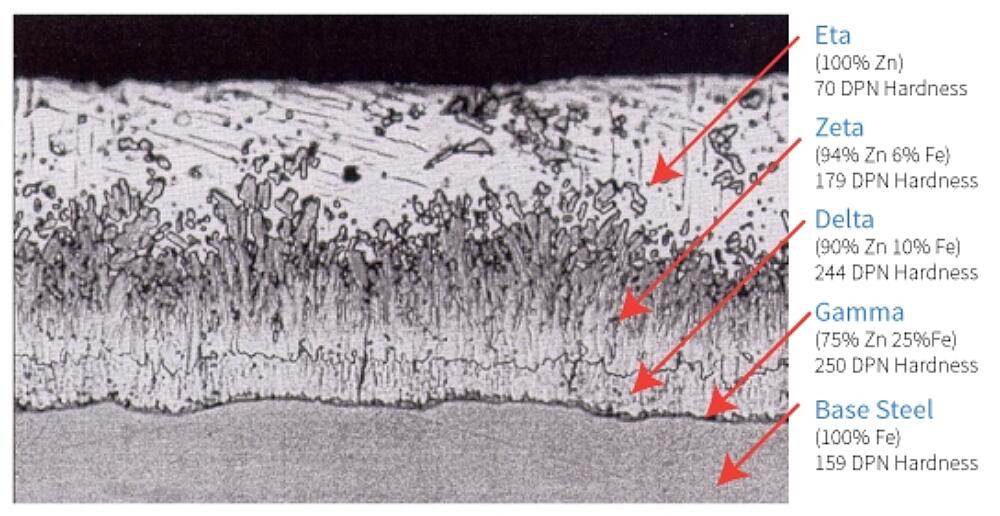

A unique characteristic of the hot-dip galvanized (HDG) coating is the development of tightly-bonded (~3,600 psi), abrasion resistant intermetallic layers. The hardness of these inner layers provides exceptional abrasion resistance while the outer and more ductile Eta layer provides some impact resistance. The combined benefits of these layers make damaging the HDG coating very difficult during rough handling, transportation, installation, as well as in service. Typically, no special handling techniques, nor specific rigging/tie-downs are required to handle HDG steel (HDG coatings can withstand chains used during transport).

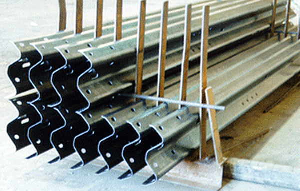

Despite hot-dip galvanizings superior durability over other industrial coating systems, it is possible to damage the coating during handling or affect coating performance by storage in a poor environment. Where it is practical, certain practices can be utilized to minimize or eliminate the potential for coating damage. The following practices should be shared with galvanizing operations personnel, the customer, and any logistics personnel to ensure expectations are met with regard to coating quality:
- Avoid stacking or contact of hot articles during cooling
- Minimize punching, drilling, or other fabrication techniques after hot-dip galvanizing
- Transport should be under dry, well-ventilated conditions.
- During transport, ensure loads are placed on the truck so the articles can be easily unloaded by forklift (i.e. on suitably sized/rated pallets, in forklift-compatible containers), and are tied down securely with restraints of the proper load rating.
- For reinforcing bar, follow recommended HDG rebar field handling techniques
- When bending articles after the hot-dip galvanizing process, perform bending at slower speeds -- some cracking or flaking of the galvanized coating at the bend may occur
- Avoid storage in contact with corrosive substances or chemicals
- Ensure proper storage and airflow to prevent the development of wet storage stain. Detailed information on best storage practices can be found within the AGA publication Wet Storage Stain.
