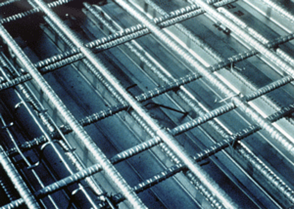

One of my customers is specifying hot-dip galvanized rebar for a new bridge. However, he is concerned about possible reactions between the zinc coating and the concrete. Are there any problems that can arise from such reactions, and is there anything special we can do to limit the reaction?
Tube reactions between galvanized reinforcement bars and concrete are only of concern during the initial curing stages of the concrete. The initial stages of curing include the time when the concrete mix is still wet. During this time the pH of the concrete is very alkaline with a pH of approximately 12.5. The wet concrete reacts with the zinc to form hydroxyzincates (Ca[Zn(OI-OH x 2 H20), which protect the zinc from further corrosion but can evolve hydrogen gas. Excessive hydrogen evolution during curing results in a more tenuous interface between the galvanized steel and the concrete, thus reducing the bond strength. Using concrete mixes with extremely high pH's may increase these reactions to unacceptable levels. Wet concrete mixes with a pH of over 13.3 have shown to significantly increase the reactions between concrete and galvanized rebar and should be avoided if possible without chromates.
The reactions that occur during the initial curing phases of the concrete can be limited by the use of chromate. Chromating the galvanized steel has shown to limit the reaction between the concrete and the zinc, thus reducing the amount of hydrogen evolved. Chromate can either be applied to the rebar directly after galvanizing, or small chromate additions can be made to the concrete mix. The amount of chromate that is added to the concrete remains in question. One study suggests that as little as 20 ppm of chromate will limit the reactions. However, it may prove beneficial to provide excess chromate (100 ppm) to ensure the reactions between the galvanized rebar and concrete are limited.

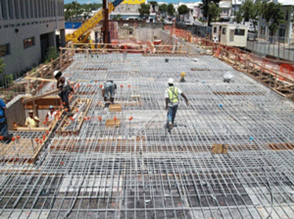

After the initial curing stages of the concrete, the reactions between the concrete and the galvanized steel cease. Once the concrete has hardened, the only access that corrosive compounds have to the galvanized rebar is through the pores of the concrete matrix. This allows the galvanized rebar to provide protection for many years.
Beyond providing long-term corrosion protection, galvanized rebar poses many other chemical advantages over black rebar. The corrosion products of steel occupy a much larger volume than the metal from which they originate and the voluminous corrosion products of black steel exert a tensile stress on the surrounding concrete. Over time, these corrosion products build up pressure on the surrounding concrete. When the pressure exceeds the tensile strength of the concrete, cracking and spalling of the concrete occurs. The cracking of the concrete creates passageways that allow further corrosive media, such as chloride salt, to enter and cause further corrosion of the rebar. While the corrosion products of zinc also occupy a larger volume than its parent metal, they have been shown to disperse into the surrounding concrete matrix, unlike corrosion products of black rebar. Increased pressure due to these corrosion products is not as substantial as with black rebar and is less likely to cause cracking of the concrete.

Chromate passivation treatments are used to control reactions between the zinc and the concrete. The main reaction that chromate treatment prevents is the hydrogen evolution that may affect the bonding properties between the zinc and concrete. Zinc is amphoteric (reactive in acidic and alkaline environments) so the maximum rate of attack on zinc occurs in alkaline conditions over a pH of 12.5. The passivation of zinc is effected in the pH range of 8 to 12.5, due to the initial formation of a layer of zinc hydroxide and subsequently of a complex calcium zinc compound, calcium hydroxy-zincate (Ca[Zn(OHbl 2H20)]. The reaction of zinc with the concrete effectively ceases in a few days and gives just sufficient corrosion products to ensure a strong and reliable bond to the concrete when fully hardened. The bonding between galvanized rebar and concrete is essential for the reliable performance of concrete structures. Many factors, such as concrete mix and additives, curing conditions, and age, may affect the bonding between the galvanized steel and concrete. The chemical reaction that is of concern is the reaction of zinc with calcium hydroxide.
This reaction occurs during the curing of the concrete. During the curing process, hydrogen gas evolution occurs between the galvanized rebar and the concrete. The use of a passivation treatment, such as the use of chromates, can help to reduce the hydrogen gas from forming. In solutions with such a high pH, the zinc is attacked by the alkalis (calcium hydroxide) in the fresh concrete, leading to the formation of calcium hydrozincite and hydrogen. This reaction could give rise to poor adhesion. Once the concrete sets, the hydrogen evolution ceases; the coating of calcium zincate formed apparently provides a protection to the reinforcement and no further attack takes places after initial setting. Tests of the bond strength on galvanized rebars showed equal to or slightly better bond performance when compared to black rebars.
