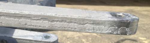

Edge flaking

Each of these thermal cutting techniques results in increased steel hardness near the cut edge, changing the diffusion properties of the steel in the HAZ and occasionally making it difficult to form a galvanized coating over the cut edge.  This issue is further complicated when the base steel has a silicon and/or phosphorus content that is very reactive in the galvanizing kettle, causing the development of a thick coating with reduced adhesion.  A thick coating which is not well adhered to a thermally cut edge can result in edge-flaking when handled.
So what can be done to prevent thin coatings and edge flaking from thermally cut edges?  For single instances where thermally cut edges are identified during inspection prior to galvanizing, it is possible to grind cut edges up to 1/16 inch.  However, where a pattern exists, demonstrating the pattern to the fabricator can help to justify grinding these areas prior to arrival at the galvanizing plant, especially for large orders and commonly galvanized fabrications.  Additionally, the use of alternative mechanical cutting methods can be discussed with the fabricator such as sawing (rotary, hack, band), grinding, turning (lathe), chiseling, drilling, or shearing.
Some of these cutting techniques produce a clean edge, but if the technique produces a significant amount of energy in the steel during the cutting process; the high-energy cutting techniques can change the local properties of the steel and increase the local steel hardness at the edge of the plate. The increase in hardness can change the diffusion properties of the steel at the edge and make it very difficult to form the galvanized coating on this edge.
This issue is further complicated when the plate steel has a silicon and/or phosphorus content that is very reactive in the galvanizing kettle. The reactive steel grows a thick coating, which in and of itself can be prone to flaking due to the stresses in the coating from the metal contraction differences in the cooling of the plate from the galvanizing temperature to ambient. Thick coatings and high stress in the plate steel can make the coating susceptible to flaking and this is due to the silicon and/or phosphorus content in the plate steel.
When the galvanized coating is thick, and the edge does not grow a well-adhered coating, the edge may show signs of flaking. This can also be propagated by handling the plate steel by forklifts and by contact with the pavement when stored on the lot at the galvanizing facility. These material handling steps can add stress to the already weak coating adherence and cause the flaking to begin at the edge. The edges of plate material should be visually examined for signs of flaking and the areas can be repaired in accordance with ASTM A780.
