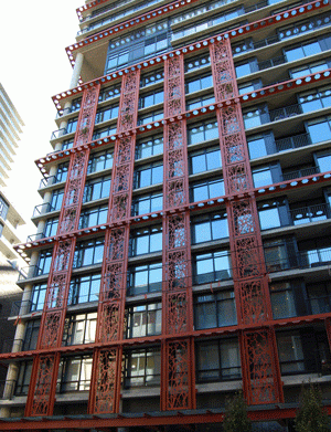

Woodwards Building
Woodwards Building
Though many specifiers are familiar with one type of corrosion protection or another, few realize the intrinsic value of utilizing two corrosion protection systems together, known as a duplex system. A duplex system is formed by painting or powder coating over hot-dip galvanized steel. When used together, the two systems work synergistically to provide superior protection rather than when used independently.
The paint or powder coating provides barrier protection to the galvanized coating. Then, when the paint or powder coating has served its useful life, the galvanized coating offers barrier and cathodic protection to the base steel. In turn, the hot-dip galvanized coating serves as an incredibly durable primer that prevents the underfilm iron-oxide corrosion which causes paints and powder coatings to fail. The combined protection of the two protective coatings (hot-dip galvanizing covered by paint or powder coating) provides corrosion protection to the steel 1.5 to 2.3 times longer than the expected life of each protective coating alone. In addition to long-lasting, superior protection, duplex systems provide architects, engineers, and other specifiers design freedom. Utilizing a combination of paint/powder coating with galvanizing means you dont have to sacrifice corrosion protection for aesthetics, or vice versa. This advantage has led to more specification of duplex systems each year.

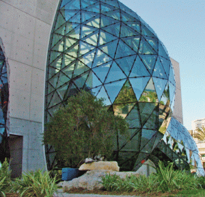

Dali Museum 15 300
The powder coated finish on the galvanized steel at the Salvador Dali Museum in St. Petersburg, Florida, allowed a color section that would blend with the facility,
