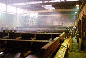

In practice, you may find the galvanizer unable or unwilling to attempt the overchemical cleaning option even though it appears to be a quick, easy, and economical method to increase coating thickness. The primary reasons are related to ability of the galvanizer and the potential for a negative impact on quality, aesthetics, and use of the parts.
Sulfuric acid is utilized by approximately 40% of galvanizers in North America, so the galvanizer may not have this option available. Furthermore, some galvanizers that use sulfuric acid also use acid inhibitors to prevent overchemical cleaning the steel during normal galvanizing operations. Overchemical cleaning can also result in negative consequences, such as creating excessively rough galvanized coatings or coatings that have uneven appearances. This can be especially problematic for parts where fit-up is of concern or where smooth surfaces are required (e.g. handrail or parts to be painted after galvanizing). Since overchemical cleaning is not an exact science, there is also risk of overchemical cleaning too long and destroying the steel by excessive chemical attack. Therefore, overchemical cleaning is also not recommended to achieve increased coating thicknesses for low-reactive steels that are part of an assembly containing steels of different chemistry and/or surface conditions due to the risk of damaging other components in the assembly.
Though overchemical cleaning can be employed successfully to increase coating thickness, the risks and ability of the galvanizer should be evaluated. In all cases, direct communication regarding “low reactive” steels provides the galvanizer an opportunity to propose alternative galvanizing procedures to maximize the chance for increased coating thickness and suitable quality.
