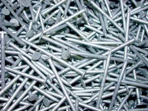

Often when purchasing zinc-coated nails, there is a misunderstanding about the difference between the methods that can produce a zinc coating on steel. There are four common methods used to coat nails with zinc: hot-dip galvanizing, tumbler hot-galvanizing, electroplating (electro-galvanizing), and mechanical zinc plating (peen-plating). Knowing the differences between these methods is valuable when assessing the corrosion protection required for a project. A summary of the properties of different methods for coating nails with zinc is presented in Table 1.
