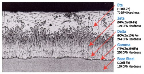

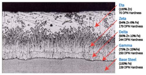

Abrasion Resistance of Coating Surface
The delta layer is a highly abrasion resistant surface layer of the high-temperature galvanized coating, leading to the misconception that high-temperature galvanizing provides a coating of greater abrasion resistance than traditional hot-dip galvanizing.  Although the hardness of the delta layer certainly provides exceptional abrasion resistance, this layer is also present within traditional hot-dip galvanized coatings along with a similarly abrasion resistant Zeta layer.  In addition, the outer and more ductile Eta layer (pure zinc layer) provides impact resistance. The combined benefits of these layers make damaging the coating very difficult during handling, transportation, installation, or even in-service.
Galvanized  Coating  Layers 2016  English
