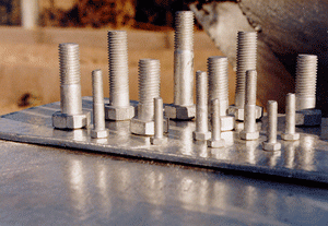

Galvanized Fasteners
The Fastener Quality Act (FQA) was enacted after several high-profile fastener failures in the 1980s. The U.S. Congress investigated and found widespread issues throughout the industry related to standards, quality control, safety and inspection. Furthermore, overseas suppliers were providing counterfeit certificates and poor quality.
In order to protect the public from further failures, the FQA requires:  conformance to the specifications to which they are manufactured; accreditation of the laboratories engaged in fastener testing; and inspection, testing, and certification in accordance with standardized methods. It can be common to experience this requirement for DOT work, overhead signs, etc.
The FQA only applies to items such as metallic bolts, nuts, screws, studs (0.25 in / 6 mm or greater), or through-hardened direct tension-indicating (DTI) washers. When a fastener subject to the FQA is to be hot-dip galvanized, ASTM A153 Paragraph 6.4 states:
6.4  The method of sampling for fasteners that are required to meet the standards of the Fastener Quality Act is described in Guide F1470. Sample quantities and definitions of terminology are included in the referenced specification.
For the galvanizer, the primary exception to the act is for fasteners manufactured in a facility registered to a recognized quality system such as ISO 9000. Practically speaking, if your galvanizing plant is ISO certified, you will already be in compliance with the act and require no further action than galvanizing to ASTM A153 standard. The other exceptions to the act are within the control and specification of the owner.
Otherwise, to help your customer remain FQA compliant, you will still hot-dip galvanize to ASTM A153, but instead of utilizing the inspection sampling protocol in ASTM A153 Paragraph 6, you will need to utilize the sampling protocol outlined in ASTM F1470, Practice for Fastener Sampling for Specified Mechanical Properties and Performance Inspection.
F1470 outlines two different types of inspection lots:  Production Lot Detection Process and Production Lot Prevention Process. The differences in the types of lots entail different sampling plans, which specify the number of test articles for performing various test methods during inspection of the finished product. It is important to ensure the customer specifies which type of lot is required.
To determine how many samples are required to test for conformance to ASTM A153 based on the lot type and size, refer to F1470 Table 3 below. Under F1470, the acceptance number in all cases is zero defects.
