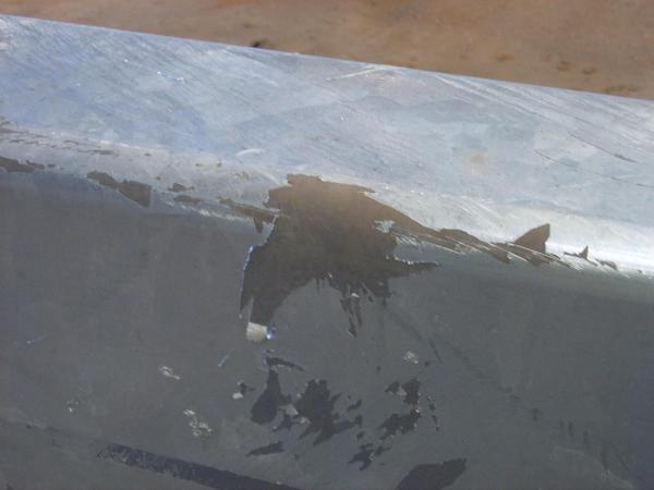

After large diameter or thick tubular steels are galvanized, these products often retain significant heat because hot air tends to remain trapped inside instead of rising up and away from the parts. These parts take longer to cool and galvanizers should be aware an extended cooling time can impact coating layer formation and overall appearance.
Galvanized products that take a long time to cool in the air will continue to form zinc-iron layers after they have been removed from the galvanizing kettle. This continued coating formation leaves behind a void between the top two layers of the galvanized coating, known as the Kirkendall Effect. If there are many voids formed, the top layer of zinc can separate from the rest of the coating and peel off the part.
Figure 1 Peeling 02
Figure 1 - Peeling
To avoid peeling (Figure 1), large diameter and thick tubular steels should be cooled quickly and then handled when below 600F. Quench cooling the parts is ideal for rapid cooling, but when quenching is not an option the parts can be maintained at a steep angle to allow the hot air to rise from within the tube and then sprayed lightly with water over the surface. It is recommended to use a very fine mist spray of water, as other spray methods can negatively affect aesthetic appearance with a spotty look.
