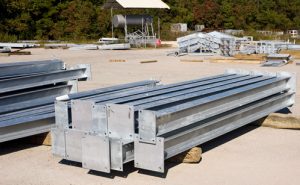

The lot size is an important component of HDG inspection because it is used to determine the total number of test articles and measurements required to ensure the quality of hot-dip galvanized coatings provided by the galvanizer.
However, sometimes confusion can arise as to what constitutes the definition of an inspection lot, especially for large orders where multiple material shipments of a single order are hot-dip galvanized over a period of several days, potentially using more than one kettle. Additionally, it may be required to differentiate between inspections performed at the galvanizing facility and by the purchaser after delivery.
The definition of an inspection lot size at the galvanizing facility differs slightly between the governing hot-dip galvanizing specifications (ASTM A123, A153, and A767).  Additionally, ASTM A123 is the only specification which identifies separate definitions for inspections performed at the galvanizing plant and by the purchaser after delivery. The definitions and examples below can be used to differentiate between the specification requirements.

7.2  A lot is a unit of production or shipment from which a sample is taken for testing. Unless otherwise agreed upon between the galvanizer and the purchaser, or established within this specification, the lot shall be as follows: For testing at a galvanizers facility, a lot is one or more articles of the same type and size comprising a single order or a single delivery load, whichever is the smaller, or any number of articles identified as a lot by the galvanizer, when these have been galvanized within a single production shift and in the same bath. []
To condense the specification language, a lot, in this case, consists of:
  • Articles of the same type and size comprising a single order or single delivery (whichever is smaller).
  • And articles identified as a lot by the galvanizer when (both must be true):
    • The articles are galvanized within a single production shift.
    • The articles are galvanized in the same galvanizing bath.
For example, lets imagine that fifteen identical 20ft long pipes have been delivered in a single shipment to the galvanizing facility under one order.  Five pipes were galvanized on Day 1 in Kettle #1.  The remaining ten pipes were galvanized on Day 2, but five of the pipes were sent to Kettle #1 while the other five pipes were sent to Kettle #2.  As a result, three inspection lots are required for this order because of the two-day production span and use of two kettles.
