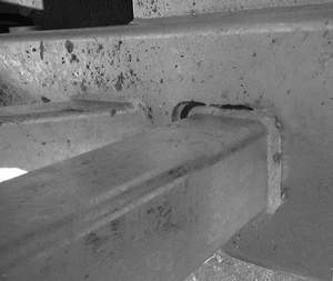

Cracking due to High Residual Stress
Prior to hot-dip galvanizing, complex design and standard fabrication methods can result in areas of high residual stress. Afterward, these structures are dipped at an angle into the galvanizing kettle, resulting in uneven and rapid heating of steel to around 830 F. If efforts are not made to relieve or control areas of high residual stress, then the additional thermal stress from the hot-dip galvanizing process can occasionally result in cracking at the most highly stressed area, and minor bath elements can assist in growth of the cracks.
Although the good news is that these structures and the surrounding coating can be repaired, this information is often not enough to address the customers concerns. What can be frustrating to the customer is they may have successfully galvanized the same structure design for many years and only now encountered a problem. This is because this type of cracking issue does not happen all of the time, but only occasionally when the conditions are just right.

Cut/Welded Areas and the Heat Affected Zone
The stresses from welding are from the weld metal itself, as it is typically harder and stronger than the base metal. The welding process also increases the hardness and reduces the ductility of steel in the area around the weld known as the heat-affected zone (HAZ). As a result, a highly stressed location is created and is more susceptible to brittle fracture.
Thermal cutting techniques also introduce a significant amount of energy in the steel, and can alter the microstructure and properties of the steel within the heat affected zone (HAZ). As a result, thermally cut steel can be extremely sensitive to residual stresses, especially if the surface of the cut remains rough.

Framed Areas & Welding Steel of Varying Thickness
When two steels of different thicknesses are assembled and brought up to galvanizing temperature, the thinner steel heats up and expands more quickly than the thicker steel. If the thicker steel restrains the thinner steel from expanding freely, or if any component is constrained by framing, this will add even more stress to an already highly-stressed area such as the joining weld.
