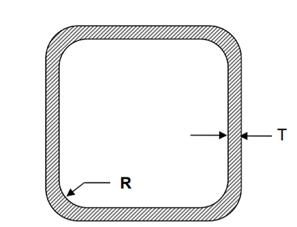

Anytime cold worked steels such as HSS products are to be hot-dip galvanized, the specification ASTM A143 Practice for Safeguarding Against Embrittlement of Hot-Dip Galvanized Structural Steel Products and Procedure for Detecting Embrittlement should be consulted for best practices to avoid severe cold working which could increase the potential for strain-age embrittlement. In the manufacturing of HSS, cold working occurs when a flat steel coil is deformed plastically into the final desired shape. To avoid strain-age embrittlement, ASTM A143 states it is best to keep bend radii as large as possible when forming and bending, but preferably a minimum of three times the steel thickness (3 x T). ASTM A143 does not explicitly specify whether the the minimum bending radius of 3 x T applies to the inside or outside radius, but relevant industry research confirms this recommendation refers to the inside radius.
Figure 1 Typical Structural Tube Rhs Ref 1
Figure 1: Typical Structural Tube RHS (Ref. 1)

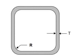

The North American standard for square and rectangular HSS (ASTM A500 Specification for Cold-Formed Welded and Seamless Carbon Steel Structural Tubing in Rounds and Shapes) requires the maximum outside bending radius be 3 x T, where T is the wall thickness of the as-produced HSS. This requirement results in an inside maximum radius of 3T – T = 2T (Figure 1) which is below the recommended bend radius provided in ASTM A143.

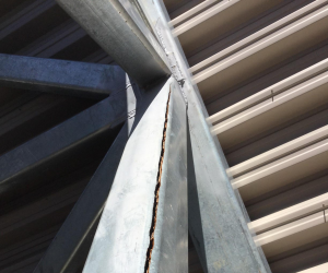

Square and rectangular A500 HSS members are galvanized successfully all the time, but such tight corner radii can occasionally lead to cracking in the corners (the most highly stressed areas) upon galvanizing. The potential increases as wall thickness increases or when other internal stresses are present from the welding or framing of the parts (Figure 2).
Figure 2 Cracking Of Rhs In Welded Assembly
Figure 2: Cracking of RHS in Welded Assembly

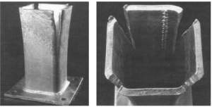

Another example of a cracking phenomenon related to HSS products is shown in Figure 3. This phenomenon usually occurs when one end of a tube is connected to a baseplate, and the entire tube tries to expand while immersed in the galvanizing bath. The baseplate constrains movement on one end of the tube, and stresses flow up the structure and away from the confined stress at the baseplate.
The result is high residual and thermal stresses in the transverse direction that cause the other end to explode and crack at the most highly stressed area(s). In square and rectangular HSS, the cracking location would be observed at the corners instead of the weld seam.
