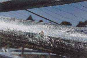

Chain marks
Figure 1: Chain marks on a hot-dip galvanized product.
 One surface defect can be caused when steel is hung on lifting racks using chains or wires, and transported around the galvanizing plant. Chain or wire marks, like those seen in Figure 1, can sometimes be avoided by proper hanging and transporting techniques. However, some products must be hung in a manner that will create chain or wire marks in order to be galvanized.

Any surface defect that creates a bare spot that is below the acceptable size criteria for a repairable area and that is properly repaired by the galvanizer is not cause for rejection. According to ASTM A123, the definition of a repairable area is the total area of bare spots on a product must not exceed 0.5% of the accessible surface area to be coated, or must not exceed 36in2  per short ton (256cm2 per metric ton), whichever is less. This means any products with bare spots that meet this definition must be repaired by the galvanizer in accordance with ASTM A780. However, any products with bare spots that exceed this definition must be rejected. They can be stripped and re-galvanized. It is the galvanizers responsibility to properly handle products during the galvanizing process to minimize surface defects, and it necessary, repair any bare spots that may occur.
A type of surface defect occurs when steel is lifted and transported using chains and wires attached to overhead cranes. Lifting devices can leave uncoated areas on the finished product that will need to be renovated. Superficial marks, like those seen in the image to the right, left on the galvanized coating from the lifting attachments are not grounds for rejection unless the marks expose bare steel; in such a case, the galvanizer must repair the bare areas before the part is acceptable.
