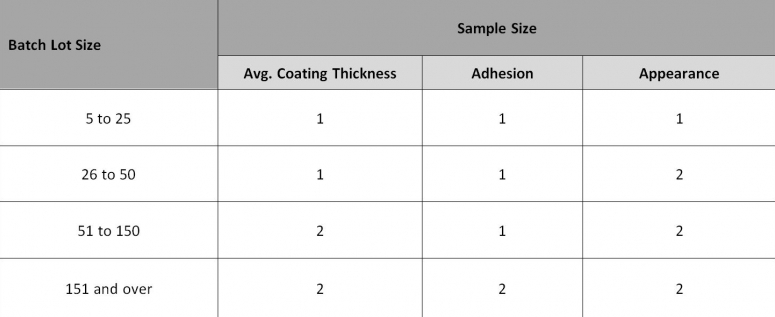

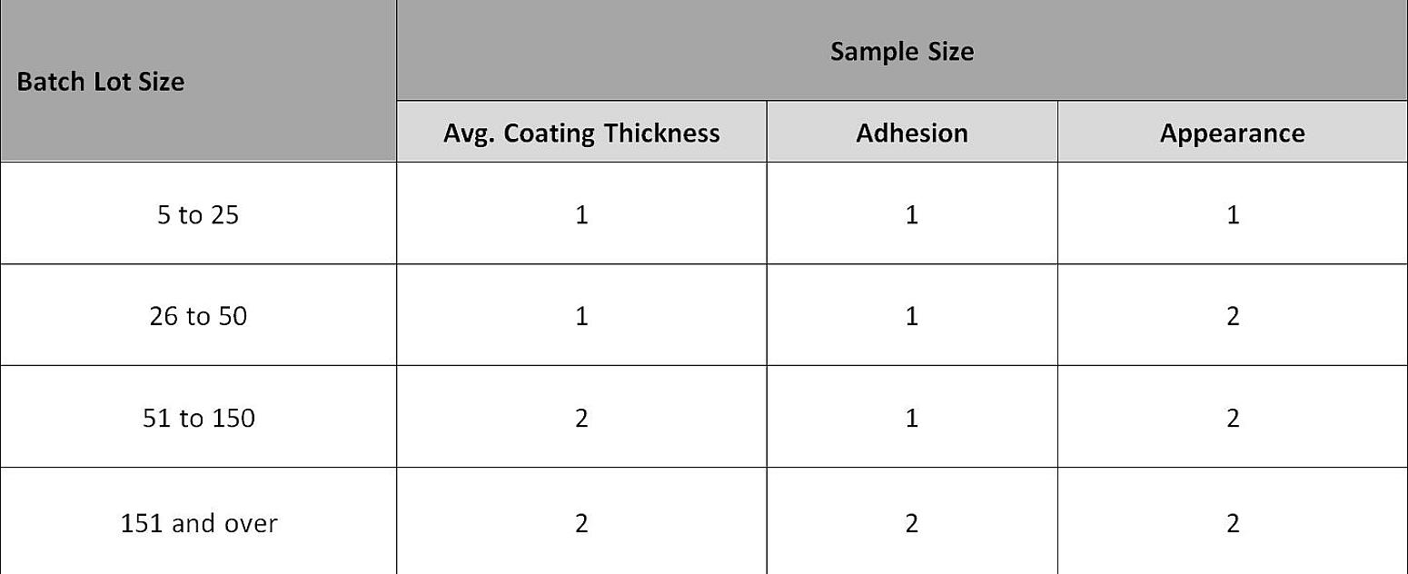

A batch lot is defined as a quantity of identical parts cleaned, pickled, fluxed, and galvanized together at one time in a galvanizing basket. F2329 Table 1 provides the sampling plan for batch lots. The batch lot inspection process is more similar to inspection under A153 than inspection of production lots, but Table 1 of F2329 has some additional requirements to consider. See excerpt of Table 1 below.
Table 1 Dr
F2329 Batch Lot Sampling Plan (Ref. F2329 Table 1)
There are three columns listing the number of test articles for three different inspection tests required under F2329:  coating thickness, adhesion, and appearance. Compared to the sampling plan in A153, F2329 requires fewer samples per batch lot size, but the galvanizer is required to also conduct adhesion testing and visual inspection for appearance on these test articles as defined by Table 1. It is important to note the acceptance criterion in all cases is zero defects.

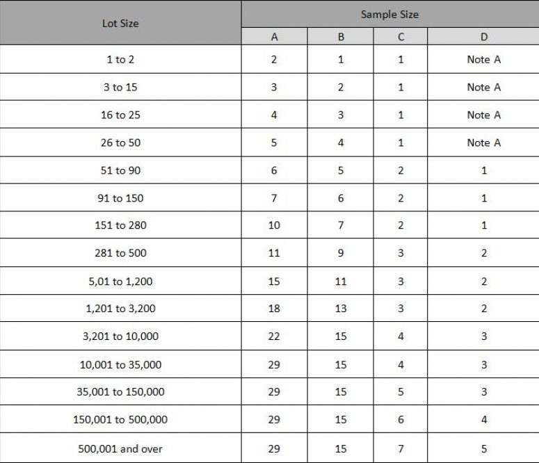

Production lots are defined as batches of parts originating from the same manufacturing lot, processed continuously through cleaning, chemical cleaning, fluxing, dipping in molten zinc and spun in a centrifuge, or other means, without any significant change in time, temperature, and concentration of the constituents of the process. There are two types of production lots one for a detection process and the other for a prevention process. For each of these types, there are also inspection criteria for coating thickness, visual appearance, and adhesion. The acceptance number in all cases is zero defects. To determine how many samples are required to test for conformance based on the lot size, F2329 refers to Table 3 of F1470, Practice for Fastener Sampling for Specified Mechanical Properties and Performance Inspection.
Production Lot Sampling Plan
F2329 Production Lot Sampling Plan (Ref. F1470 Table 3)
Note A:  Suppliers shall furnish certified test results from which the shipping lots originated. If certified test reports are not available, then the supplier must default to Sample Size C and conduct the tests required.

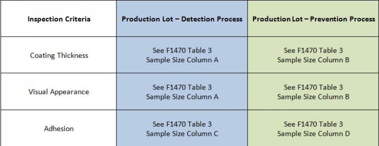

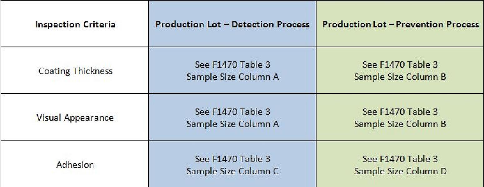

The type of production lot process will determine which column should be referenced for the sample size of each inspection criteria, as summarized in the table below, or per the F2329 Sampling Plan Flow Chart. For example, a lot size of 500 articles under the detection process requires testing of 11 samples for coating thickness, 11 samples for visual appearance, and 3 samples for adhesion.
