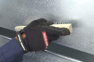

Typically, non-structural adhesives (rubber based types of cement, tapes, stickers, etc.) require a clean surface free from dust, oil, grease, and loosely bonded corrosion products. Degreasing and cleaning can be performed in accordance with SSPC-SP 1 Solvent Cleaning.
Higher strength adhesives may require light abrasive cleaning (wire brushing or sanding) prior to degreasing to remove any zinc corrosion products and/or provide a textured surface. Be careful not to over-roughen the surface or remove too much zinc as to negatively affect the long-term corrosion resistance. Additionally, the use of an adhesive primer or etch primer (compatible with the adhesive product) may be recommended by the manufacturer for superior adhesion.
If maximum surface cleanliness is required, chemical cleaning using an acid rinse can be applied after degreasing. However, the use should be controlled to minimize attack on the coating, and thorough rinsing should be performed twice with fresh water to ensure all corrosive chemicals are removed.
