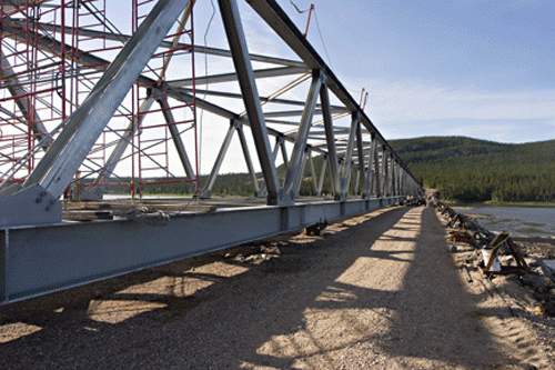

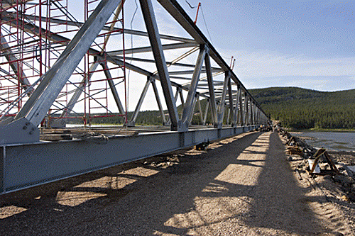

Churchill Bridge
Churchill River Bridge

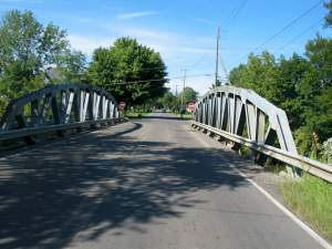

Bridges of Stark County
Stark County Ohio Bridge

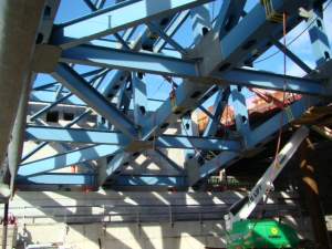

Lowell Bridge
Lowell Bridge

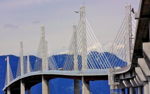

Golden Ears Bridge
Golden Ears Bridge
