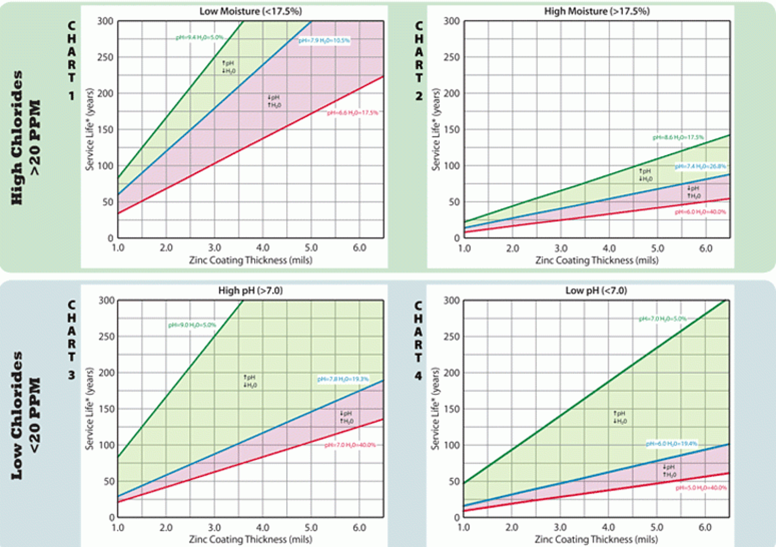

In Soil
Coarse and textured soils, such as gravel and sand, permit free circulation of air, and the process of corrosion may closely resemble atmospheric corrosion. Clay and silt soils have a fine texture and hold water, resulting in poor aeration and drainage. The corrosion process in such soils may resemble the corrosion process in water.
Corrosion research on different types of soil suggests a linear relationship between galvanized coating thickness and performance and the existence of four basic and distinct soil conditions, each with a different effect on buried hot-dip galvanized steel. There are critical limits for pH, water content, and chloride concentration which determine the durability of the galvanized coating. In between the limits, as pH, water content and chloride concentration vary, so too does the corrosion rate of the hot-dip galvanized steel coating. Since most galvanized structural steel has at least 3.9 to 5 mils of zinc coating, estimated service life in the harshest soil is 35 to 50 years and in the less corrosive soil, 75 years or more. The estimate of service life utilized here is years to complete corrosion of the zinc coating plus an additional time of 25%, to account for partial corrosion of the steel member. This provides the project engineer with information to determine the time to replacement or maintenance for non-critical items such as ground rods and reinforced earth wire to more critical structural components such as pilings, utility poles, and guardrail posts. The AGA has compiled corrosion data and service life estimates for hot-dip galvanized steel in soil (Figure 2).

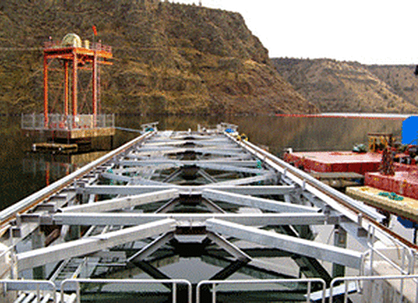

In Water Fresh Water
Galvanizing is successfully used to protect steel in freshwater exposure. Freshwater refers to all forms of water except sea water. Freshwater may be classified according to its origin or application. Included are hot and cold domestic, industrial, river, lake and canal waters. Corrosion of zinc in fresh water is a complex process controlled largely by impurities in the water. Even rain water contains oxygen, nitrogen, carbon dioxide and other dissolved gases, in addition to dust and smoke particles. Groundwater carries micro-organisms, eroded soil, decaying vegetation, dissolved salts of calcium, magnesium, iron, and manganese, and suspended colloidal matter. All of these substances and other factors such as pH, temperature, and motion affect the structure and composition of the corrosion products formed on the exposed zinc surface. Relatively small differences in freshwater content or conditions can produce relatively substantial changes in corrosion products and rate. Thus, there is no simple rule governing the corrosion rate of zinc in fresh water. However, one trend data supports is hard water is much less corrosive than soft water. Under conditions of moderate or high water hardness, a natural scale of insoluble salts tends to form on the galvanized surface, which slows the corrosion rate of the galvanized coating.
