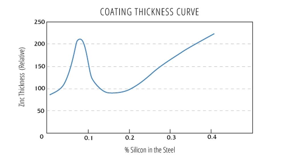

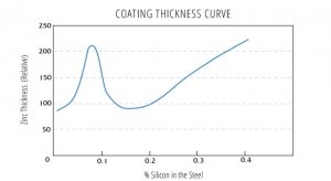

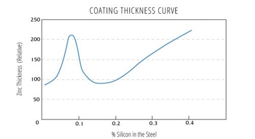

The Silicon Equivalent
Steels with silicon and phosphorus levels which are beyond the recommended levels are considered reactive steels. Reactive steels are galvanized regularly, and the silicon equivalent is used to evaluate the combined effect silicon and phosphorus have on the metallurgical reaction during hot-dip galvanizing. After the Silicon equivalent has been calculated, look up the value on the Sandelin Curve to predict the reactivity of the steel.
Silicon Equivalent = Si content + 2.5*(P content)
- Silicon equivalent <0.04% or 0.15% - 0.22% - coatings are of typical thickness and appearance.
- Silicon equivalent 0.04% - 0.15% (Sandelin steels) - vary in appearance and develop thicker coatings. If a nickel alloyed zinc bath is used, the Sandelin effect is mitigated, resulting in a higher likelihood of bright coatings of typical coating thickness.
- Silicon equivalent > 0.22% - matte gray and rough coatings of a thickness greater than the minimum requirements. See Sandelin curve to determine the level of reactivity and anticipated coating thickness.
