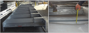

Figure 1: Assymetrical Fabrication
The design of the part in Figure 1 includes a top flange from channel material but has no corresponding bottom flange to make the design symmetric. This allows the buildup of stress during the thermal expansion of the part in the galvanizing kettle to be relieved by distorting the entire piece from one end to the other, following the most likely rolling direction of the steel used for the web portion of this part.

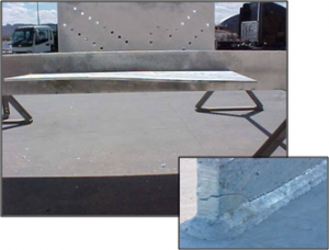

Figure 2: Plate Welded to Side of Beam
Figure 2 shows a fabrication where a plate was welded to the side of a beam. When this fabrication was brought up to galvanizing temperature, the thermal expansion proceeded at different rates for the beam and the plate. This put considerable stress on the plate as it tried to expand more rapidly than the beam, however, the welding together of the two materials did not allow for separate movement. Since the plate material cannot move near the weld joint, it relieved the stress build-up by distorting away from the weld joint and cracking the weld joint.
