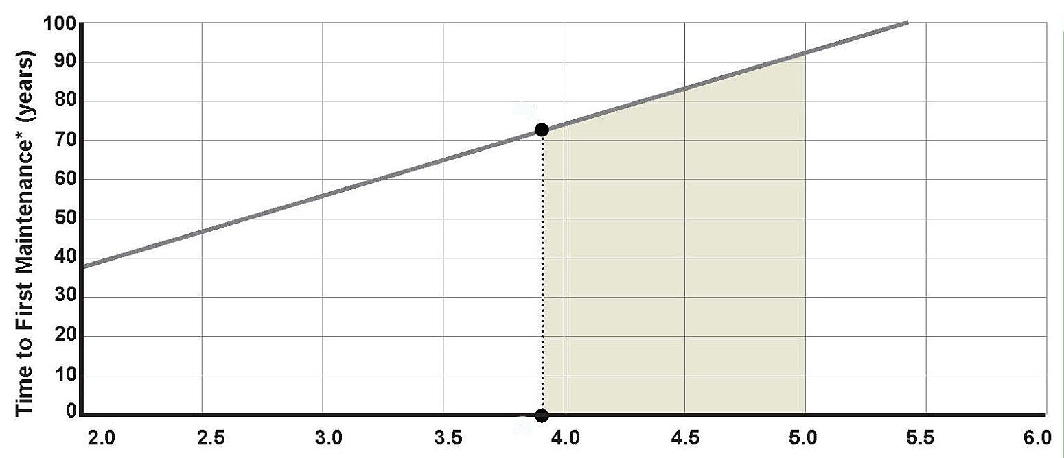

Specifiers generally use the Time to First Maintenance Chart to estimate the life of a hot-dip galvanized coating. The chart shows a time to first maintenance of the coating (vertical axis) vs. the thickness of the coating (horizontal axis). Therefore, simply finding the horizontal line where the projects corresponding climate type line intersects the vertical line representing the coatings thickness will indicate an estimated time to first maintenance.
Therefore, to estimate time to first maintenance, you will need to know the thickness of the coating and the climate where the project will be located. While it is not possible to specify an exact thickness of a hot-dip galvanized coating, North American galvanizers will meet the requirements of ASTM A123 Standard Specification for Zinc (Hot-Dip Galvanized) Coatings on Iron and Steel Products. Table 1 of the standard contains requirements for minimum average coating thicknesses on various steel products. A quick look at this table tells specifiers what thickness is required under ASTM A123. For larger structural steel pieces (1/4 inch thick or greater), the minimum average coating thickness under ASTM A123 is 4.0 mils, but coating thickness averages often exceed these minimums and will usually be in the 3.9 to 5.0 mil range. To determine which climate the project is located in, it may be helpful to compare the climate of the area in question with the example cities used to generate the chart. Below is a table containing the cities used as examples in each climate

The chart below gives an example of an estimated time to first maintenance for large structural steel that has been hot-dip galvanized. The shaded area represents a typical coating thickness of 3.9 to 5.0 mils on the horizontal axis. For simplicity, only the plotline for an industrial climate is shown; all others have been removed. With this coating thickness range and this climate type, the vertical axis shows the coating will survive 70 to 90+ maintenance free years before requiring touch up or repair.
