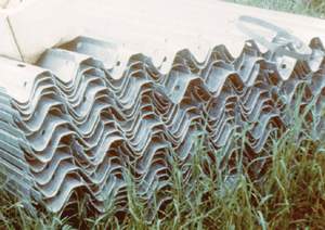

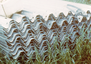

Figure 1 : Improperly stacked galvanized pieces can result in wet storage stain.
Ive had a few customers complain about white powder on their newly galvanized steel - this sounds like wet storage stain to me. What can I do, and what do I tell my customers to do to prevent wet storage stain?
Wet storage stain is a white or gray powdery deposit that can develop on newly galvanized articles when they are stacked on top of one another and moisture from the quenching process or atmosphere gets between them. The improper stacking or nesting of steel (Figure 1) can prevent adequate airflow to the zinc surfaces and cause premature consumption of the zinc coating. Essentially, the trapped moisture presents the natural formation of the zinc corrosion films, collectively called the patina.

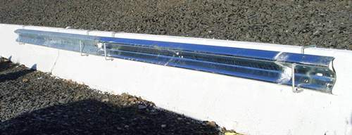

Figure 3: In order for the galvanized coating to form the zinc patina, medium and heavy (Fig. 4) storage stain MUST be removed.

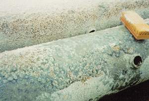

After the galvanized surfaces are dried, the treatment processes differ depending on the severity of the wet storage stain. Wet storage stain ranges in severity from light to medium to heavy. After drying, light wet storage stain, as seen in Figure 2, can be left to weather as long as it will have adequate airflow as the storage stain will convert to patina as it reacts with carbon dioxide. If the airflow will be restricted, or the surface is likely to have more standing water on it, then the wet storage stain must be removed by brushing it off with a stiff-bristled, nylon brush then the part can be exposed to its normal service condition.

Figure 2: The section of guardrail on the left shows the effects of wet storage stain, while the right side is unaffected.

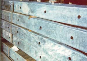

Medium (Figure 3) or heavy (Figure 4) wet storage stain must be removed in order for the galvanized coating to form the zinc patina, otherwise, the service life of the zinc coating and underlying steel can be affected. After removing the wet storage stain by brushing with a stiff-bristled, nylon brush and a cleaning solution, it is best to measure the coating thickness to ensure an adequate zinc coating remains on the base steel. When medium or heavy wet storage stain becomes black, a significant amount of the zinc coating has been consumed and the steel must be stripped and re-galvanized to meet ASTM specifications.
Preventing wet storage stain is easier than treating it. Prevention includes removing standing water and providing adequate airflow over newly galvanized surfaces, as well as avoiding tightly stacking products on top of one other. When products must be stacked closely together, using spacers will increase airflow to areas susceptible to wet storage stain.

Figure 4: Heavy storage stain
