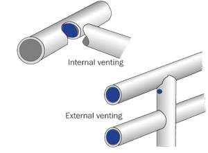

The primary reason for vent and drain holes is to allow air to be evacuated from within and around the fabrication, allowing it to be completely immersed in the cleaning solutions and molten zinc and for the excess zinc and solutions to drain out and away from the part.
The secondary reason is if fabrications to be galvanized are not properly vented, cleaning solutions or rinse waters trapped in overlapping or contacting surfaces flash to steam. The resulting pressure increase (up to 3600 psi [25MPa]) can rupture the fabrication. Additionally, trapped moisture that flashes to steam can result in localized uncoated surfaces.
Because items being galvanized are immersed in and withdrawn from all cleaning solutions and molten zinc at an angle, vent holes should be located at the highest point and drain holes at the lowest point as mounted during the galvanizing process.

Internal Venting
Internal Venting

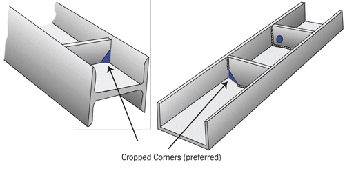

A few common fabrications where drainage is important are gusset plates, stiffeners, end-plates, and bracing. Following these best design practices will help ensure the highest quality coatings:
Corners
Corners

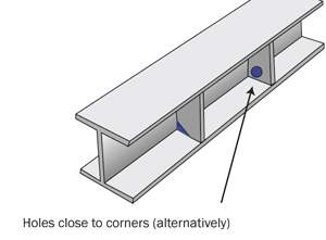

  • Where gusset plates are used, generously cropped corners provide for free drainage. When cropping gusset plates is not possible, holes at least 1/2 (13 mm) in diameter must be placed in the plates as close to the corners as possible.
  • To ensure unimpeded flow of solutions, all stiffeners, gussets, and bracing should be cropped a minimum of 3/4 (19 mm).
  • Provide holes at least 1/2 (13 mm) in diameter in end-plates on rolled steel shapes to allow molten zinc access during immersion in the galvanizing bath and drainage during withdrawal.
  • Alternatively, holes at least 1/2 (13 mm) in diameter can be placed on the web within 1/4 (6 mm) of the end-plate. To facilitate drainage, end-plates should have holes placed as close to interior corners as possible.

Cropped Corners 1
Cropped corners
