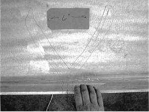

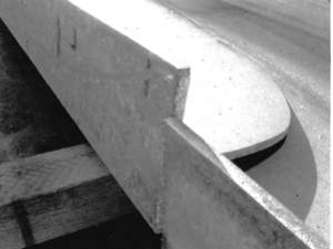

As an example, one galvanizing company called us a short while ago with a not so typical story. Some I-beams that were galvanized exhibited cracking in the web o the I-beam. The pictures below show how severe this cracking became. The second beam almost cracked into two pieces. The galvanizer immediately identified the problem to his customer and then the fun started. Once all the involved parties were contacted with the details of the situation, the first step was to test those beams that had already been galvanized and were in the yard at the galvanizers as well as those that were delivered to the job site. The beams were tested with a magnetic particle to locate cracks that are not visible to the naked eye. Out of the 20 beams that had been galvanized, seven showed evidence of cracking. Now, the problem seemed to be getting bigger.
The next step was to call in all of the interested parties; including the steel manufacturer and its metallurgist. The first question was whether the cracked beams could be fixed. The group wanted to know the extent of the cracking. The black beams that were on the galvanizers lot were examined and one of the beams had a visible crack before hot-dip galvanizing. It was time for a detailed examination of the beams. Four black beams were spot checked with magnetic particle testing and all four showed evidence of cracks in the flange area. The number of microcracks that were found by magnetic particle testing was in the hundreds and there was a pattern to the cracking. The cracks were located in the flange of the beam every ten feet. This was almost the same pattern as the stamped logo for the steel manufacturer reported to the group that their logo pattern was indeed every ten feet, in the same location as the cracks.
G2
The steel manufacturer described the process of producing the beam and the logo pattern was hot stamped every ten feet along the flange. The beams were then cold bent before galvanizing to produce a curve in the beams. The cold bending process had put so much strain on the areas around the logos that micro-cracks had developed. The steel metallurgists then told the group that the hot-dip galvanizing process was not the cause of the cracks and had actually helped find the cracks before the beams were put into service. The other logos that were seen between the stamped logos were generated during the bending process and they did not have cracks.
The solution to this particular problem would be to grind out the cold-formed logos prior to galvanizing to prevent strain-age embrittlement of the I-beam after the galvanizing process. If the micro-cracks that were formed from the cold-worked logos are ground out, this will eliminate potential for strain-age embrittlement.
