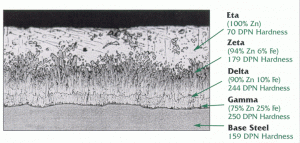

The chemistry of the steel can make it impractical
Some customers may want you to leave the steel in the zinc bath for a longer amount of time in order to produce an extra thick coating. This may be an option for reactive steels, where the thickness of the coating grows linearly with time. However, if the steel's silicon and phosphorous levels are within the recommended ranges for hot-dip galvanizing as provided within ASTM A385, the rate of the galvanized coating thickness growth will be parabolic with time, that is the growth will peak and then decline. After a short span of a quick growth rate, the thickness will grow much slower, making a much thicker coating impractical to achieve. Specifying "reactive steel" chemistry or "high-silicon" steel does not guarantee a thicker coating to the requested value will be achieved, and the use of reactive steels can sometimes result in coatings which are dull or rough in appearance/texture. In practice, stripping and regalvanizing is not a reliable or predictable method for altering the surface chemistry and should not be exercised as an attempt to meet thicker coating requests.

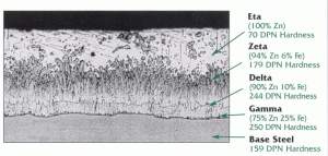

"Double dipping" the steel does not work
There seems to be a perception that a galvanized coating is similar to a paint coating: you can apply multiple coats to achieve a greater thickness. However, a hot-dip galvanized coating actually relies on a reaction between the steel and zinc, forming intermetallic layers that grow perpendicular to the base steel. Once the coating has cooled, redipping the material into molten zinc may only melt away the free zinc (Eta) layer of the coating and replace it with a new one upon removing it from the bath. The intermetallic layers will only grow once the steel is heated back to the galvanizing temperature. A longer initial immersion time will have the same effect as a second immersion and is a much more efficient option. The term 'double dipping' should not be confused, or used interchangeably with the term progressive dipping. Progressive dipping is done when a piece is too large to be fully submerged in the galvanizing kettle, so each end of the piece is dipped sequentially to coat the entire item.
