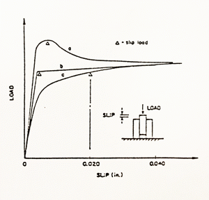

Slip resistant connections are usually used only when they are specified in design. The slip coefficient is controlled by a number of factors including the amount of clamping force, nature of the contact surfaces in a given connection, tensile area, nominal bolt area, bolt tensile strength (length and diameter), and the proof load. The nature and development of slip and fatigue on structural joints can be  very misleading, especially with different surface conditions. The slip coefficient, ks, is defined to be the ratio of the force causing slip at the contact surface to the normal force between the plates resulting from bolt tension.
Slip
Figure 1
ks = slip load 2 x clamping force
Slip load can be graphically represented by Figure 1 shown below. When comparing mill scale steel to that of galvanized surfaces, the coefficient of friction heavily favors the mill scale steel. Studies showed that the average slip coefficient for bare or mild steel was twice the value of newly galvanized steel. But when the galvanized surface was treated with wire brushing or brush-off blasting, the reported slip values were twice the original value of untreated galvanized steel.
In reality, the slip coefficient and actual clamping force vary widely so frequency distributions are used to calculate slip probability levels. These probability levels signify the percent chance the joint will slip into bearing under specified loads. In Figure 2, typical slip coefficient values are shown.

At low initial load pressures, slip occurs in galvanized structural joints faster than that of mill scale steel or non-coated steel. But the galvanized joint has a property called the lock up phenomenon, which occurs during increasing continuous applied pressure.
If the load is large enough and applied in the same vectored direction, the joints will slip into bearing. But if the load is periodically reversed, the dynamically loaded structures slip will cease after a few cycles of loading. Even if the galvanized surface has not been pretreated, the slip movement in the joint produces the frictional resistance required in friction type design. Although there might be some early slip in the galvanized joints, the fatigue resistance was equal to or greater than the ungalvanized joints. Therefore galvanized connections could be designed for fatigue loadings, and grit blasting or wire brushing is only necessary when initial slip is detrimental to the design. After disassembly of some representative galvanized plates, the actual joint was required to be pried off the galvanized surface of the plate, this is a result of the cold welding effect associated with lock up. This property is sometimes termed creep deformation, referring to the displacement of the coating between the steel due to compression. Creep deformation of a specimen is calculated using the average reading of the two displacements on each side. If the creepdeformation of any coating exceeds the design slip deformation, the coating will cause failure in the joint.
It is evident that after an insignificant movement, galvanized steel joints resist slip as well as or better than bare steel. If a slight movement can be negligible, then the galvanized structural joint can succeed in providing the necessary friction forces detrimental in joint design. If initial movement is undesirable then the galvanized joints can be physically etched in order to attain higher friction coefficients.
