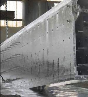

First, lets familiarize you with some basics of the hot-dip galvanized coating — its formed by an interdiffusion reaction of iron and zinc. The nature of the reaction is that iron and zinc mix at the surface of the coating and form intermetallic layers. These alloy layers grow perpendicular to the steel and produce a uniform coating on all surfaces of the underlying steel, as well as corners and edges. Therefore, the coating is nearly the same thickness on threads as it is on the head of bolts or other flat surfaces.
Coatings for hardware items and small parts are specified per ASTM A153, Standard Specification for Zinc Coating (Hot-Dip) on Iron and Steel Hardware. The process for producing clean thread coatings is to centrifuge the hot-dip galvanized part immediately after it comes out of the zinc bath to throw off any excess zinc from the threaded areas. The threads are then smooth and consistent in coating thickness.

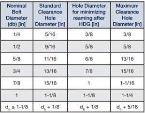

For slip critical connections, a clearance hole 1/8 inch larger than the nominal bolt diameter is sufficient to provide a clearance hole that will accommodate a galvanized bolt without the need of extra hole cleaning. For slip critical connections involving bolts sized one inch or greater, specify standard clearance hole sizes in accordance with ANSI/AISC 360 Specification for Structural Steel Buildings or AASHTO LRFD Bridge Design Specifications, as the standard hole is already sized 1/8 inch greater than the bolt diameter. For connections where the specified bolt size is less than 1 inch, specify oversized holes which are 1/8 inch greater than the nominal bolt diameter.
For other types of connections that require more hole clearance for alignment reasons, the maximum dimensions for oversizing can be found within Section J3.1, Table J3.3 of the AISC LRFD manual, or in Table 1 of this article.
