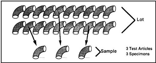

Figure 1: Single-Specimen Articles

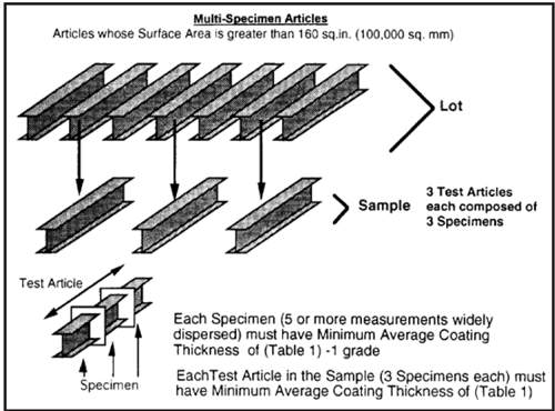

For single specimen products, each specimen is randomly selected. For thickness measurement tests, a minimum of five widely dispersed measurements are taken over the surface area of the specimen in order to represent the average specimen coating thickness. The average value of the five coating thickness measurements must be greater than or equal to one grade below the minimum average coating thickness for the material category. In Figure 1, the separation of a lot into a sample and an individual specimen is shown. A multi-specimen product is defined as having a surface area larger than 160 in2 (1032 cm2), or has multiple steel thicknesses, or contains more than one coating category. In order to test coating thickness of products whose surface area is greater than 160 in2 (1032 cm2), they are subdivided into three continuous local sections with equivalent surface areas, each of which constitutes a unique specimen. In the case of any such local section containing more than one material category or steel thickness range, that section will contain more than one specimen.
In Figure 2, the separation of a lot into a sample and an individual specimen is shown. For products that are hot-dip galvanized following either ASTM A123 / A123M or A153 / A153M, Table 1 is used to determine the minimum number of specimens for sampling from any given lot size. For rebar that is hot-dip galvanized according to ASTM A767, The information below is used to determine the minimum number of samples per lot, measurements per sample, and the total number of measurements required for each of the different coating thickness measurement techniques.
S1
Figure 2: Multi-Specimen Articles

The minimum average coating thickness for a lot is the average of the specimen values and must meet the minimum for the material category.  The minimum for an individual specimen is one grade below the minimum for the material category. An individual measurement on a part has no minimum thickness requirements but bare areas are not allowed. All parts that do not meet these requirements must be resorted and reinspected or rejected and re-galvanized.
