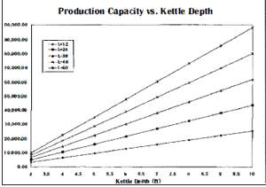

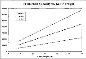

The previous two suggestions are used to increase the efficiency of your current kettle. The next suggestions only apply if you are changing out your kettle. The following two plots show the relationship between kettle geometry and production capacity. The plot Production Capacity VB Kettle Length shows the geometry of three different kettles. As you can see, an increase ii1 length gives a slight "increase in production capacity for these kettles. There is about a 7 percent increase per foot of kettle length. A more dramatic increase in production capacity can be seen in the second plot of Production Capacity vs., Kettle Depth. Increasing the depth by as little as one foot can have a significant effect on the production capacity.
This plot shows production capacity versus depth for a number of different, kettle lengths. The kettle width is held constant at four feet. A change from a four-foot depth to a six-foot depth can double your production capacity. If you hold the kettle length and. kettle depth constant and increase the kettle width, production capacity goes down slightly due to increased heat losses at the kettle surface. Once you determine your kettle capacity, you can determine the efficiency by calculating the weight of steel through the kettle per hour compared with the production capacity of the kettle. A shortened kettle life can occur if you are significantly running the kettle over the capacity. If you are significantly under the production capacity, you can increase efficiency by running more weight per lifts or fewer plant hours. A galvanizing plant's efficiency is determined by the production capacity of the kettle.
