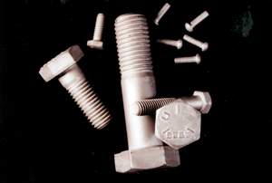

When treated wood is used in order to prevent damage that may be done by wood-destroying insects and termites in a dry environment, then corrosion is of less concern. Users and specifiers should also be aware that corrosive industrial areas or environments with a high level of salt in the air might also require the use of appropriate corrosion resistant metals. Connectors used for ACQ or CA-treated wood should be manufactured from steel and then hot-dip galvanized for corrosion protection. In addition, stainless steel connectors, types 304 or 316, are also suitable for pressure treated lumber. For borate treated wood, used in interior applications, the same connectors can be used. Fasteners used for ACQ or CA-treated wood should be hot-dip galvanized in accordance with ASTM A153. In addition, stainless steel fasteners are recommended, if appropriate. However, fasteners used in combination with metal connectors must be the same type of metal to avoid galvanic corrosion caused by dissimilar metals. For example, stainless steel fasteners should not be used in combination with galvanized connectors.
