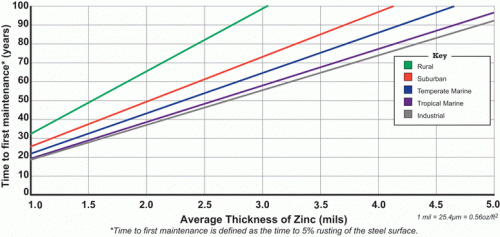

For hot-dip galvanized products, a key feature is durability and decades of maintenance-free performance.  However, to plan for the extension of a products service life and facilitate long-term budget planning, the estimated time to first maintenance in atmospheric exposures can be seen in the chart below.
Time to first maintenance chart
For any environment, the service life of hot-dip galvanized steel is directly proportional to the thickness of the zinc coating.  Thus, coating thickness is an important requirement in the specification and effectiveness of hot-dip galvanizing as a corrosion protection system.
