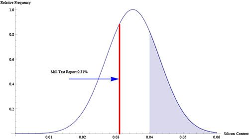

Lets go through an example of what may happen with a mill test report and how it can misrepresent the silicon level you happen to have received. First of all, we can assume the silicon content in a population of steel can be represented by Gauss law of Normal Distribution. This means there will be an average silicon level and, if more samples were taken, we could predict what other silicon levels will be with a known level of confidence. However, only one unit is sampled and further information on the silicon distribution is not recorded. Lets say, for example, the average silicon level within a heat of steel is 0.035% with a standard deviation of 0.008%. The Gaussian curve shown below illustrates this distribution with the shaded portion denoting the reactive range of above 0.04%. Again this information would not be known by you and is only used here as an example.

Now lets say the steel mill selects one random unit for analysis and produces a mill test report. You are presented with this mill test report, or certification, that is supposed to represent the entire population, reporting a silicon content of 0.031% (Shown by the vertical red line on the chart). This is a level that falls below the reactive range of the Sandelin curve and should prove to have little complications during the galvanizing process. But we now know, the one unit sampled does not necessarily 100% represent your steel. You can see from the chart, the silicon level reported has a very good chance of being inaccurate and misleading. Within the population represented by the chart, the silicon value has a very good chance of falling into the 0.04% or above range. There is no way of telling if the steel you have is accurately represented by the unit used by the mill to produce their report. If a larger sample size was taken, and an average was reported, the population would be better represented with a lower error.
