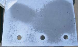

Mottling
After galvanizing, the steel cools from a temperature of approximately 840 F to ambient temperature. If the steel is quenched, cooling takes place rapidly, but not all galvanizers have quench baths and quenching is not recommended on some designs due to the potential for warpage/distortion of the steel. When the newly galvanized steel is allowed to cool naturally (without quenching), it can take several hours for the steel to come down to ambient temperature. Thinner steel cools faster while thicker steel takes longer to cool. Sometimes an individual piece of steel will have different cooling rates.
Appearance2
Mottling (acceptable)
For example, the outer portion of a square plate can cool quicker than an interior portion. Because the interior portion remains hotter longer, it is possible for the galvanizing reaction to continue as long as that area is above 550 F and the continued reaction consumes the outer free zinc (eta) layer in the process. Because the galvanizing reaction continues on the interior portion and consumes the free zinc layer, but not the exterior portion of the steel (meaning the free zinc layer remains in those areas), this causes a nonuniform appearance of the galvanized coating; however, this difference in appearance does not affect the corrosion protection of the galvanized coating and is acceptable per ASTM specifications.

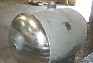

Dull and Shiny on the Same Piece
Appearance 3
Shiny vs Dull (acceptable)
The most common reason for galvanized steel to have different appearances is the chemistry of the steel pieces. There are two elements of steel chemistry which most strongly influence the final appearance; silicon and phosphorous. Both elements are catalysts to coating growth, and the thicker coating is responsible for the differing appearance.
In addition to producing thicker coatings, highly reactive steels tend to have a matte gray or mottled appearance instead of a typical bright coating. This difference in appearance is a result of the rapid zinc-iron intermetallic growth. This growth of the intermetallic layer is out of the galvanizers control; however, if he is aware of the steels composition beforehand, he can utilize some process controls to minimize the effect. Sometimes connected (welded) galvanized pieces or even the same piece of steel will have different appearances (varying light and dark areas) due to steel chemistry. This is often observed  when connecting different types or thicknesses of steel, but can also occur on similar pieces. Another common place this is found is in welded areas, as the silicon content of the weld rod can influence appearance. Regardless of the appearance, all of these products have an equal amount of corrosion protection and meet the specification requirements.

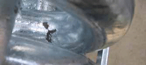

Bare Spots
Most  Common  Appearance  Concerts On  Hdg  Steel
Bare Spots (rejectable)
Bare spots, uncoated areas on the steel surface, are a surface defect that can occur because of inadequate surface preparation. Bare spots may be caused by welding slag, sand embedded in castings, excess aluminum in the galvanizing kettle, or lifting devices that prevent the coating from forming in a small area. In order to avoid bare spots, the galvanizer must ensure the surfaces are clean and without rust after pretreatment. Small bare spots can be repaired in the galvanizing shop. If the size of the bare spot or a total number of spots causes rejection, the parts may be stripped, re-galvanized, and then re-inspected for compliance to the specifications.

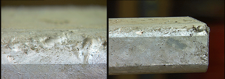

Dross Inclusions
Dross inclusions are a distinct particle of the zinc-iron intermetallic alloy that can become entrapped in the zinc coating. Dross inclusions may be avoided by changing the lifting orientation or redesigning the product to allow for more effective drainage. If the dross particles are small and completely covered by zinc metal, they will not affect the corrosion protection, and thus, are acceptable. If there are gross dross particles (large inclusions) that prevent the full galvanized coating from forming on the steel, then the particles must be removed and the area repaired.
