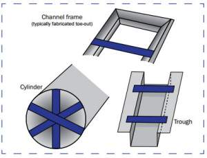

Much like the subject of steel of varying thickness, asymmetrical pieces and designs run a moderate risk of being warped or distorted when they are hot-dip galvanized. The internal stresses in angles or channel frames, for example, will not be relived evenly due to the constraints of the materials shape. T-beams and checkered plate are also examples of materials subject to warpage. Using shapes that are symmetrical around all major axes such as I-beam, pipe, or H-column, reduce the risk of warpage during hot-dip galvanizing. If it is not possible to use a symmetrical design, adding temporary bracing to asymmetrical designs lowers the risk of the fabrication warping during galvanizing.
Bracing  Dr   Galv
Temporary Bracing
