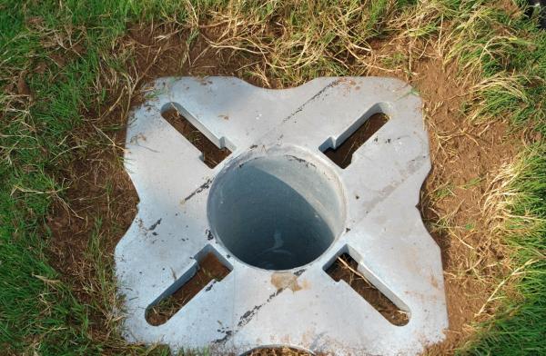

Uss  Ok  Flagpole 4
USS Oklahoma Flag Pole
